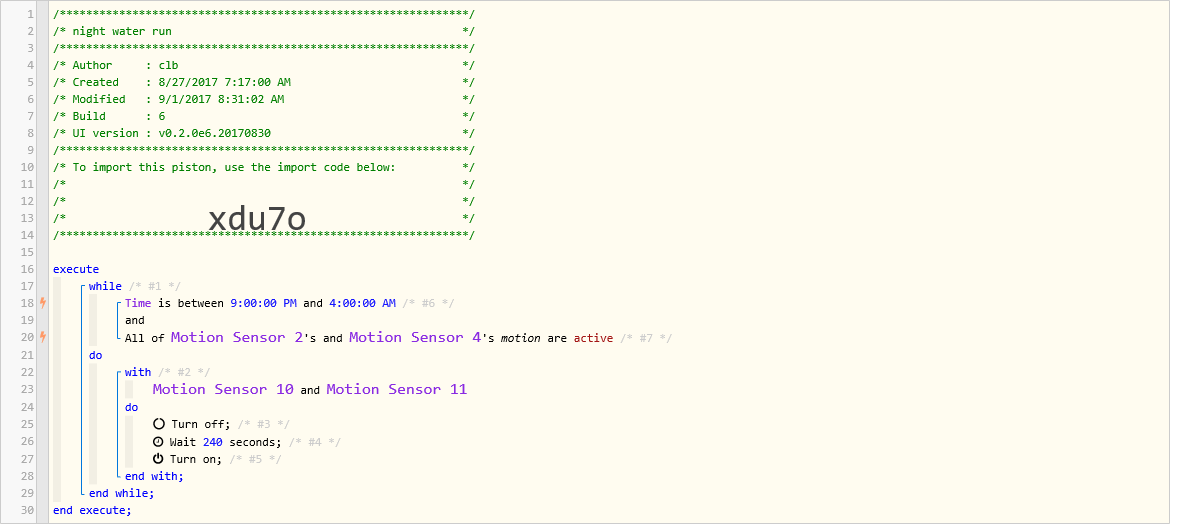

After lights out I sometimes want a drink of water from the kitchen. I have an Arlo Wireless camera in the Dining Room and Kitchen that send alerts upon motion after bedtime. Using motion sensors I successfully turn off the cameras but have not figured out how to turn them back on. Any suggestions? Thank you in advance to this awesome community.
Arlo wireless how to turn back on or activate in piston

Try changing the cancellation policy of the with to never cancel. Click on the with and click the settings cog

thank you. your suggestion to change the cancellation policy of the with to never cancel worked.
