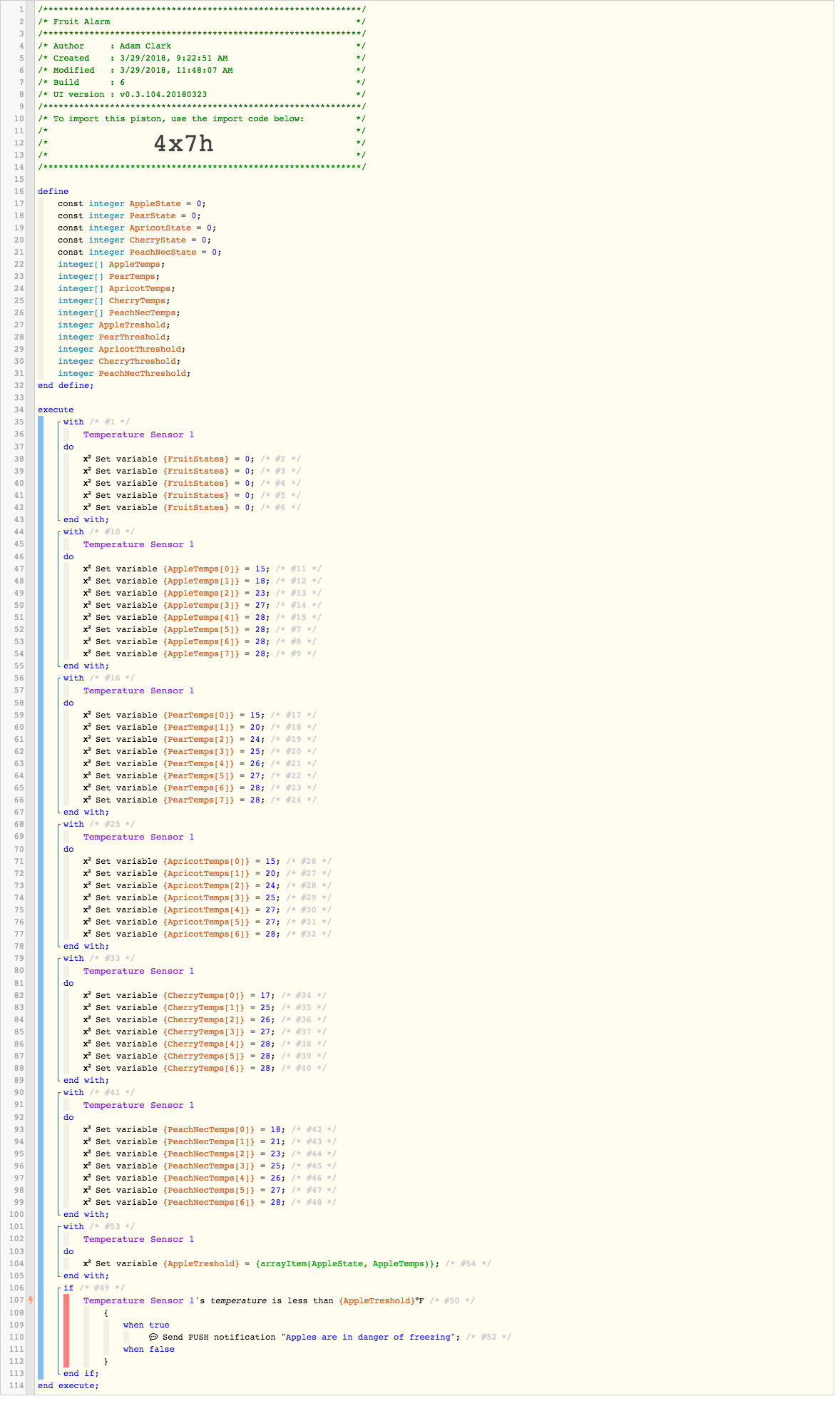

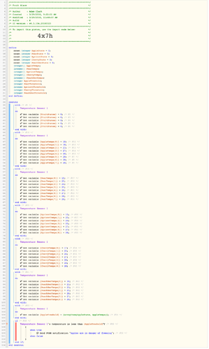

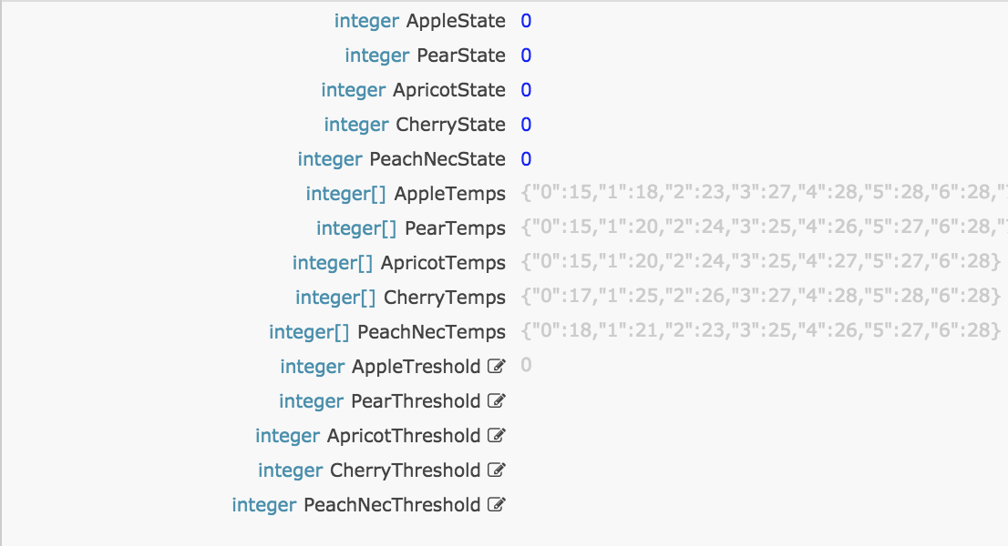

I’m not getting the expected value from the arrayitem invocation.
I expected the arrayItem(AppleState, AppleTemps) to provide a minimum temp.
I’m getting a 0 result.

|+611ms|║║Comparison (decimal) 54.0 is_less_than (integer) 0 = false (2ms)|
|+612ms|║║Condition #50 evaluated false (7ms)|
|+613ms|║║Condition group #49 evaluated false (state did not change) (8ms)|
