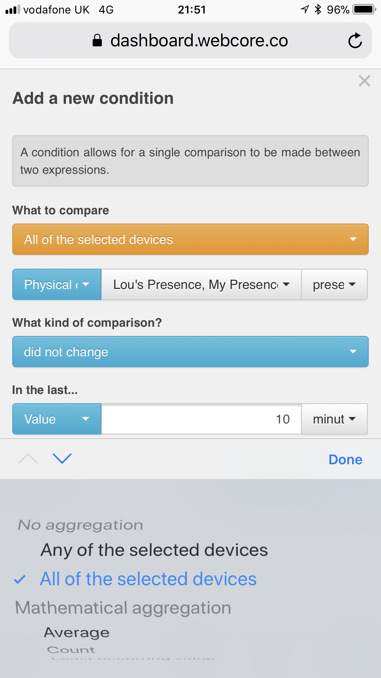

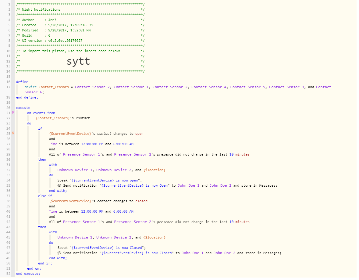

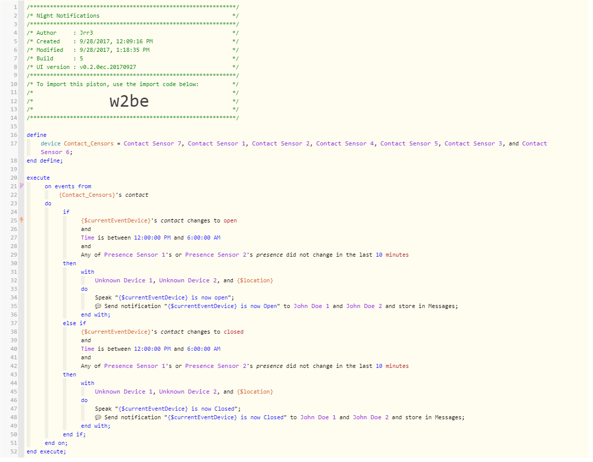

I set up this piston and it was working before I added the presence statements (line 29 & 42). What I want is if a door opens at night (ignore the current times, its for testing), I would like it to send a notification to our phones and also speak which door is open. I DON’T want it to do this though if some arrives within the last 10 min (if I come home late from work). Currently, the notification is going off, even if there is a presence change within the 10 min.
I dont want a notification if the presence changes.
Notification is still going off.
9/28/2017, 1:31:38 PM +567ms
+2ms ╔Received event [Laundry Room Door].contact = open with a delay of 328ms
+166ms ║RunTime Analysis CS > 17ms > PS > 58ms > PE > 90ms > CE
+178ms ║Runtime (43434 bytes) successfully initialized in 58ms (v0.2.0ec.20170927) (176ms)
+180ms ║╔Execution stage started
+208ms ║║Comparison (enum) open changes_to (string) open = true (1ms)
+211ms ║║Cancelling condition #6’s schedules…
+212ms ║║Condition #6 evaluated true (10ms)
+225ms ║║Comparison (time) 48698780 is_between (time) 43200000 … (time) 21600000 = true (9ms)
+227ms ║║Time restriction check passed
+230ms ║║Condition #11 evaluated true (17ms)
+258ms ║║Comparison (enum) present did_not_change = true (15ms)
+260ms ║║Condition #18 evaluated true (29ms)
+261ms ║║Cancelling condition #1’s schedules…
+262ms ║║Condition group #1 evaluated true (state changed) (61ms)
+265ms ║║Cancelling statement #4’s schedules…
+276ms ║║Calculating (string) Laundry Room Door + (string) is now open >> (string) Laundry Room Door is now open
+963ms ║║Executed physical command [JR Note5].speak([Laundry Room Door is now open]) (676ms)
+964ms ║║Executed [JR Note5].speak (678ms)
+1065ms ║║Executed physical command [LAN-TAB].speak([Laundry Room Door is now open]) (97ms)
+1066ms ║║Executed [LAN-TAB].speak (99ms)
+1073ms ║║Calculating (string) Laundry Room Door + (string) is now Open >> (string) Laundry Room Door is now Open
+1119ms ║║Executed virtual command [JR Note5, LAN-TAB].sendNotificationToContacts (39ms)
+1123ms ║╚Execution stage complete. (944ms)
+1130ms ╚Event processed successfully (1130ms)
