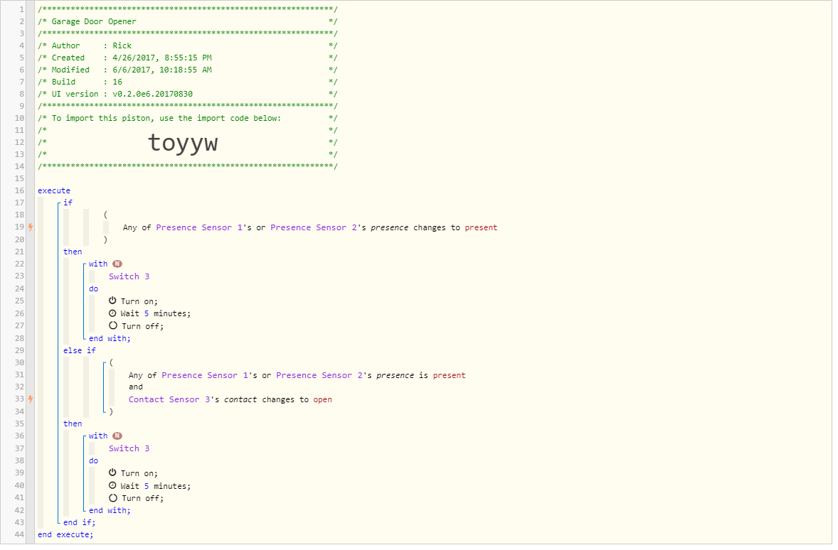

Arrival Presence isn't working
This Piston is supposed to turn on the garage door opener when either of us come home or if we are home and we open the house garage door, in both cases, it should turn off in 5 mins.
The house garage door works fine, the arrival presence doesn’t seem to work hardly at all for me and usually works for my wife
Any thoughts?
Rick

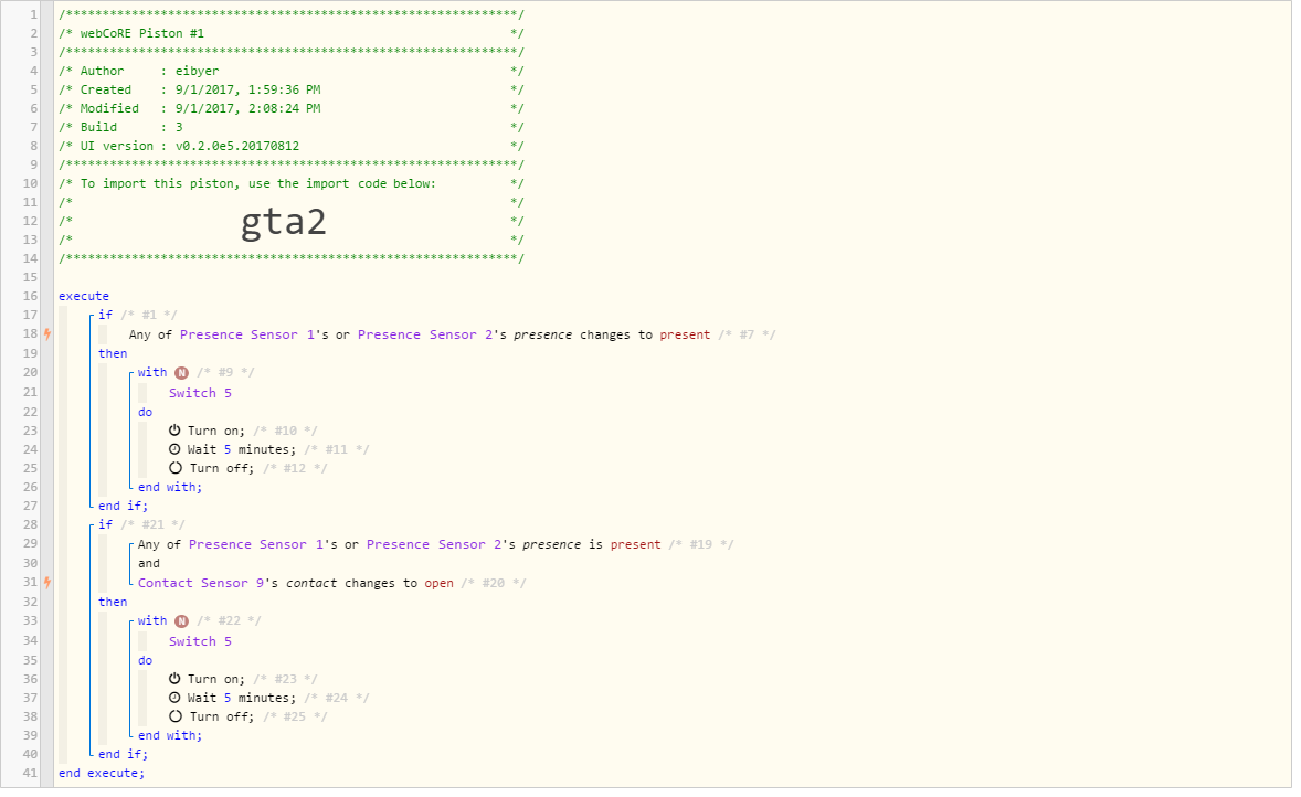

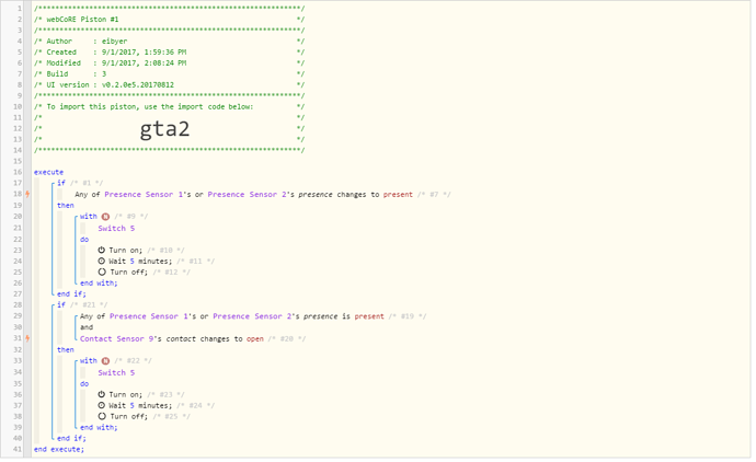

Other than the way the code is laid out, to me it should work. I imported it and rearranged it a bit, see if it works any better. Do you have any virtual presence device you can test with?
Thanks Eibyer,
I’ll give this a go. My wife will be home in about 15 mins so it will be tested then
No, I don’t have any virtual presence devices yet
Rick
Well, nothing happened when my wife came home
Her device shows she left at 5:29am and arrived at 2:52pm so I know that’s working
Rick
I’ll give it a try, back in a few.
Edit: My test worked… I changed to 15 seconds only so I can verify the timer.

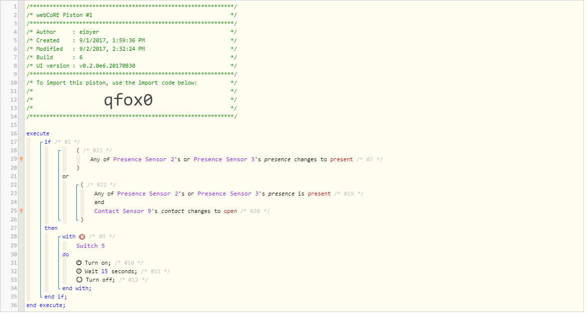

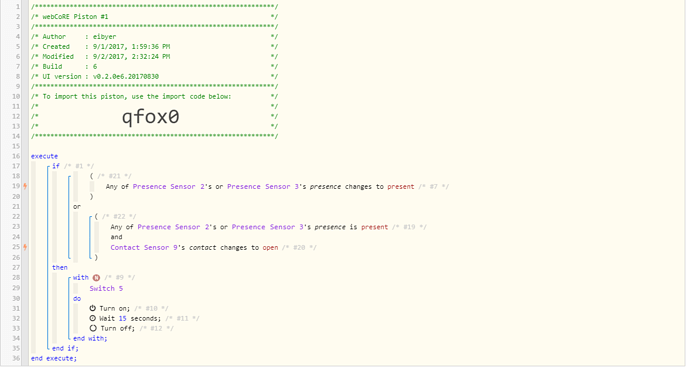

Here’s another version thanks to @bangali :slight_smile: ,always optimizing :stuck_out_tongue:
I really like this one :slight_smile:
Thanks a ton for all the help
