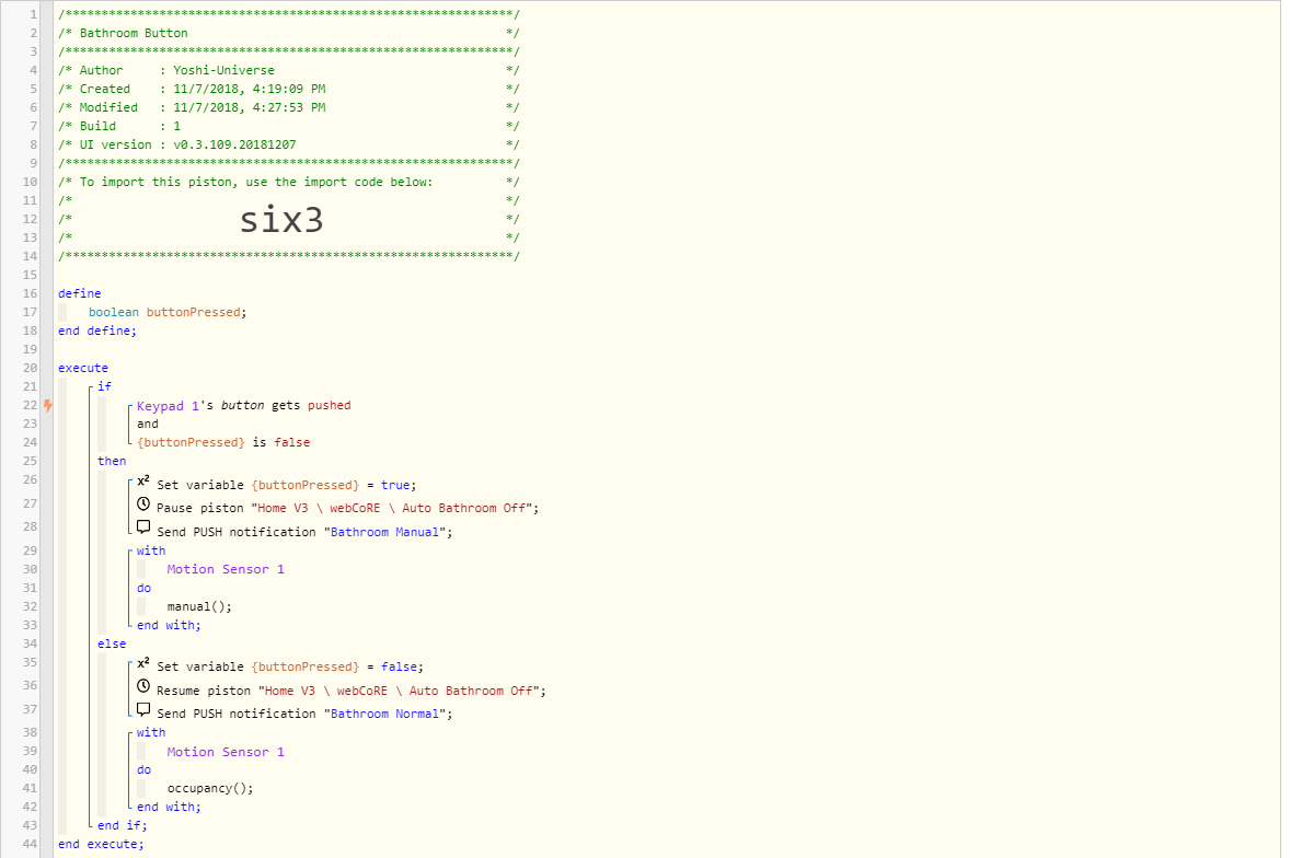

I want to include my virtual switch into my piston but I’m not sure how.
What I was like to happen is when the virtual switch is on, it sets the piston state to true and then when the virtual switch gets turned off, it sets the piston state to false. Another words, acting as the button listed in the piston. I want the virtual switch to mirror the button and vice versa.
Thank you in advance for your help. The main piston design is by @Gopack2

Will the else in this piston ever actually fire? What’s the false of a button being pushed? I think only the then part will fire for this rule. If the else does fire it’s going to be immediately after the then. Do you have logs of this piston firing?

The button controls the light in my bathroom so it doesn’t go off when i’m in the shower. The only two ways to change the lights state is by the button or by going into the switch settings and changing it back. As there is no way to interact with the button other than physically pressing it, I want another way to control the switch’s mode. A virtual switch is something that allows me to use it however i want. So if I leave the house and tell the system to turn everything off, the bathroom virtual switch will be turned off and thus returning the bathroom light to normal.
The button and/or virtual switch need to be “aware” of each other’s state so that way when I push the button to change the bathroom to manual (ON), it toggles the virtual switch on. Then if I turn off the virtual switch, it resets the state for the button.
Hope this clears up what I’m trying to do.

Yes, the only thing is that the button needs to act as a button and the switch, a switch.
So I need to have the button and switch working in unison. The button can just be a button and do button things but the switch needs to reflect the status of the lights mode. That way, i can look at my system and see what mode it’s in and tell my assistant to change to whatever status.

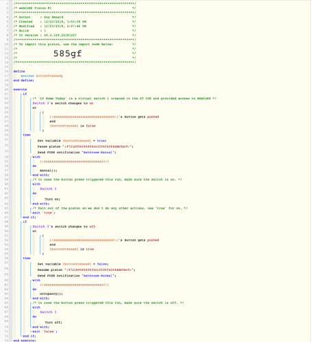

I think you just need to add in your switch and provide a little more robust logic. Try this. Note the 'xxxx’s are your original devices you will have to put in and replace my virtual switch with your own. Hope this helps.
IT WORKS!
Thank you so much!
I’m still learning code logic, etc so I really appreciated the captions. I’ll continue to play with it and learn.
Thank you again!
