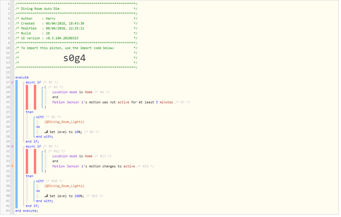

I have been building up my smart home and already have a number of pistons working happily. I have a smartthings motion sensor in a room with a load of Innr lights. I can’t get the piston to work, see below.
When there has been no activity in the room for 5 minutes, dim lights to 10%. When I come back in, turn the lights back on to 80%.
It’s not working right!

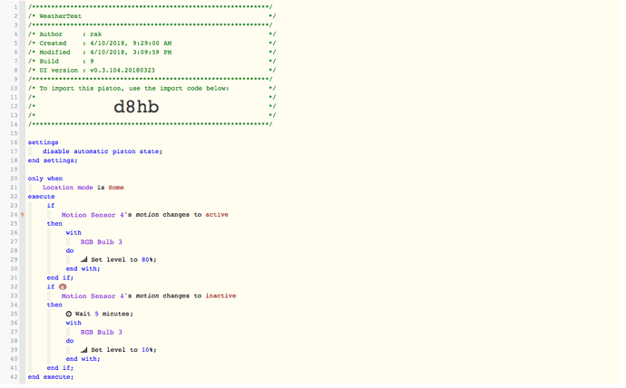

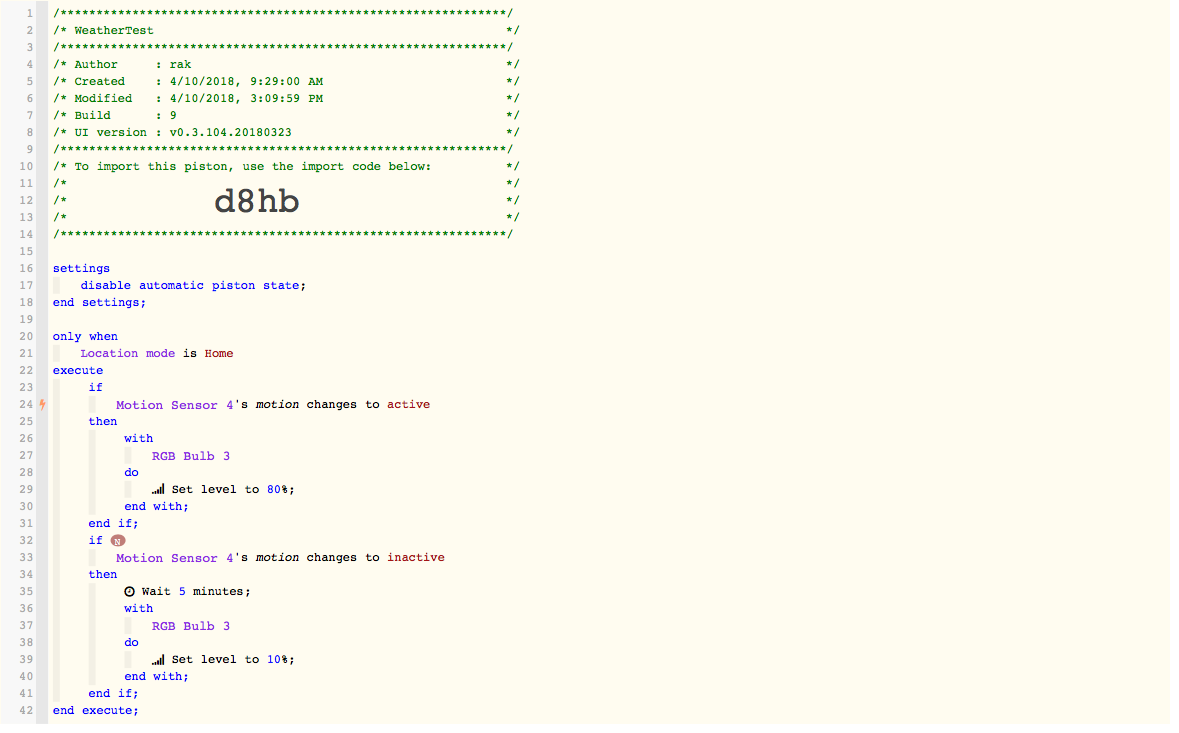

This should work… I tested it with a single light and motion sensor.
EDIT: You could also split it into 2 separate “IF” statements if you like, then use restrictions to run the piston only when location mode = home

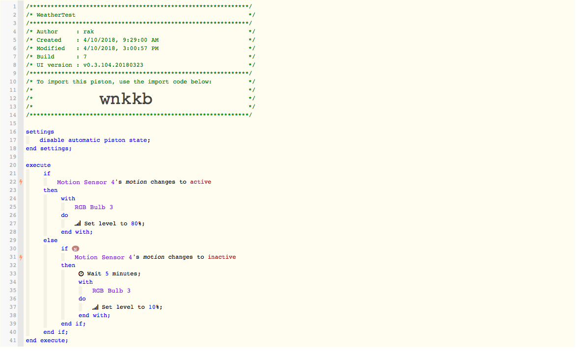

Here’s another version, split into 2 “IF” statements, using a restriction.

Excuse the newbie question- I’ve kind of got to grips with basic statements but I’ve never used the ‘Else’ bit. Can you explain what that does?
Edit- also what does the disable automatic piston state setting do?
Harry
The else works as in “if there’s not” so. If a piston is set with motion sensor active then it will come on. Else (if no motion) wait 5 mins and then dim to 10%

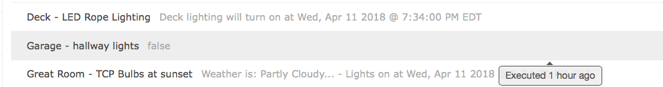

The piston state is the text that displayed next to the piston on the main dashboard.
For example, here’s a screenshot of my dashboard:
You have to “disable automatic piston state” in order to manually have it set to something else. It’s kinda just a habit for me now to set that.
