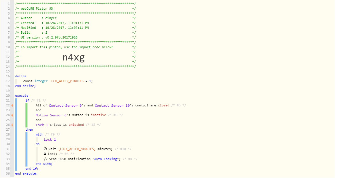

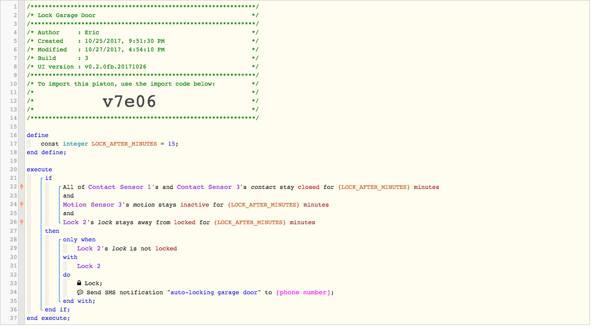

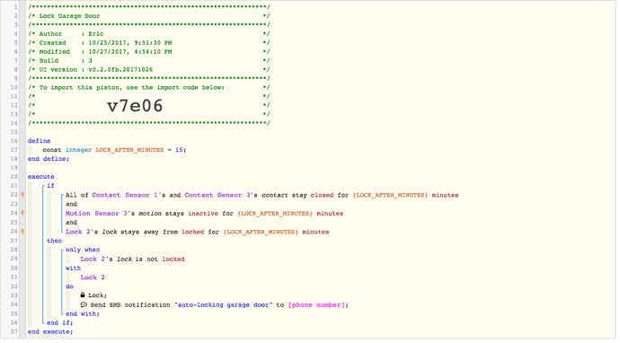

When my piston triggers due to a “stay” trigger after X minutes and not all of the triggers are met core re-schedules piston to run another X minutes in the future even though the other triggers will be true in a much shorter period of time.
X minutes after both contact sensors close and motion ceases the door should lock.
A timer for X minutes is scheduled when the door closes then a few minutes later the motion sensor goes inactive. The timer isn’t re-scheduled and when the piston triggers from the timer the motion sensor hasn’t been inactive for X minutes yet. Core then re-schedules the timer for another X minutes instead of (X - motion sensor inactivity time).
Will Post Logs tomorrow morning.
Based on reading the triggers vs conditions I’m thinking I need to have three different if blocks one for Contact 1, Contact 3, and Motion. Then for each trigger verify that all three have been closed/inactive for X minutes and then lock the door.
