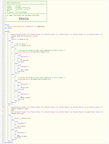

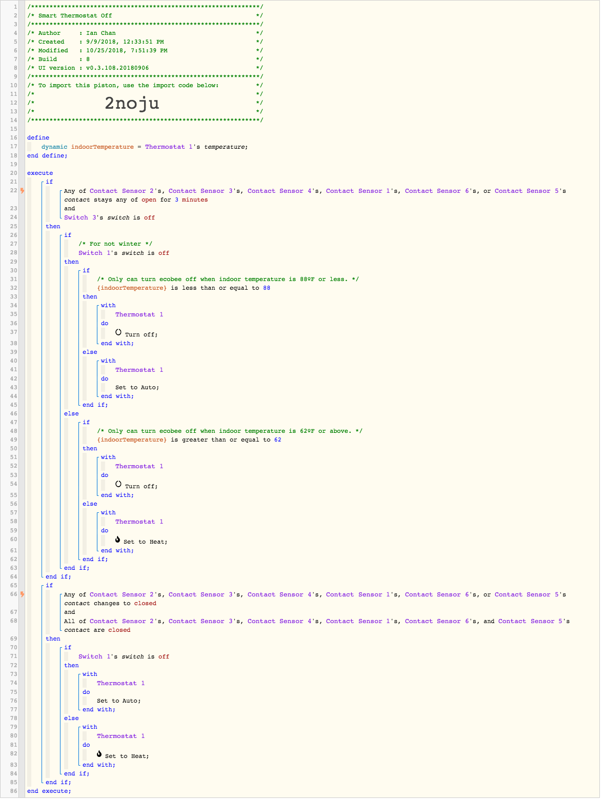

Turn off ecobee when any window is opened for 3 minutes. Turn it back on to auto or heat when all windows are closed.
The heat should be turned back on again.
I remember it used to work but today it suddenly not working. I traced the code and it did go to the section of set to heat.
