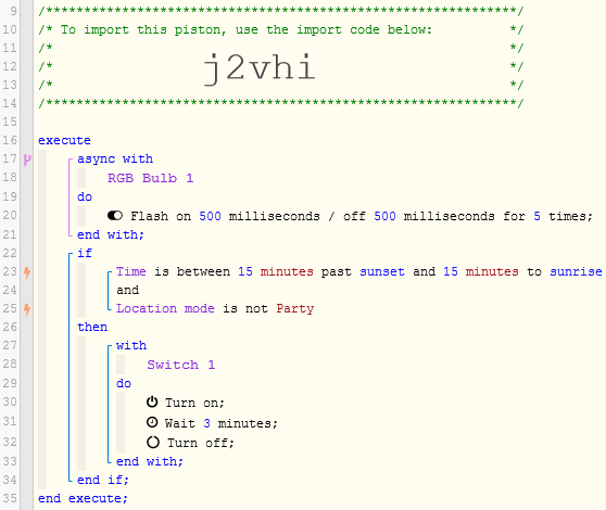

If someone approaches my front door, I want to turn on my outdoor lights for 3 minutes (and then off) and change the scene of my Nanoleaf Aurora to “Alert” (rapidly blinking colorful lights) for 5 seconds (and then return it to its prior state).
The outdoor lights should only turn on if it is dark outside (15 minutes past sunset to 15 minutes before sunrise) and only if Smartthings is not in “Party” mode (where the outdoor lights will be on manually and stay on).
I had issues with Arlo not recording when integrated with Smartthings, so I’m using IFTTT/Stringify with Arlo to make a web request into webcore.
I set up two pistons.
The “main” piston triggers the nanoleaf and the outdoor lights (per the above conditions).
The “helper” piston detects the gate and triggers the “main” piston. When the Arlo detects motion, it also triggers the “main” piston.
a) For some reason, my outdoor lights turn on around sunrise and stay on even though there was no trigger.

Okay, I’m starting to realize that my piston is getting executed at the sunrise/sunset boundaries and when the location mode changes (hence the lightning bolts). This was not my intent: I only wanted the piston to be executed when manually called (by the other piston or by my IFTTT event).
However, it seems like a bug that the light is getting left on at sunrise. Why is the “wait 3 minutes” and “turn off” not happening?
Also, I got the changeScene function that I added as a command to show up by removing and re-adding the device from webcore. Before that, my changes to the device handler (at least in terms of exposing the function) didn’t take effect.
In the piston settings change the subscription method to none. This will make your piston only executable from outside triggers like you want.

To explain the multiple executions in the log. Any time you have a command that will take more than 3 seconds to execute then the piston will schedule a wake up for that time. So the wait 5 seconds schedules a wake up as well as the 3 minutes.
Have you removed the subscriptions so this only executes from the outside source?
@c1arkbar I haven’t made that change yet… I think I need to do some more reading on schedule cancellation/reentrancy/etc, but things are starting to make sense.
I think you’re right about the Task Cancellation Policy:
The default option is “Cancel tasks on condition state change”, so if the light is turned on right before the “sunrise - 15min” threshold and then the three minute timer puts the “turn off” after the threshold, I think it gets cancelled.
Thanks for you help.
