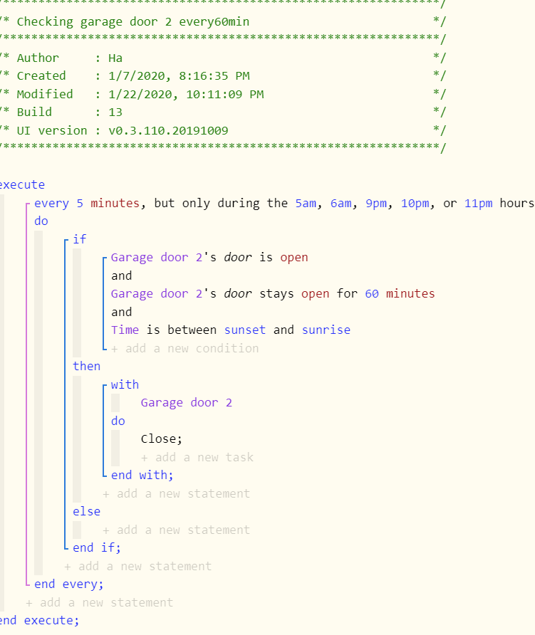

I wrote a Piston to close my garage door if it’s left open for 60 minutes between sunset and sunrise and I have the condition checked at certain hours, but nothing happened

I just used 5 minutes to test the piston. When I first wrote that I didn’t have the timer trigger, so the piston just checked it once and when the the close it won’t check again. That’s why I add the timer for it to check once awhile

I just put “and” in between, i did use it before, but after it checks and see that the door is closed, it won’t check again

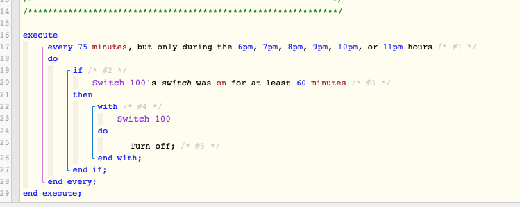

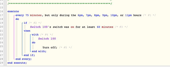

let me draft something. Hope it helps
Sorry I haven’t (couldn’t) test this because I don’t use Sts system for garage door.
Whatthis does (assuming) is, checks the sensor every 75 minutes to see if it was open.
lets say you open the door at 6.30pm but the timer fired the piston at 6.55, Since it’s been not 60 minutes YET, it won’t turn it OFF.
But next time it fires, it WILL BE more then 60 minutes and the door will be shut.
once again sorry couldn’t test this.
