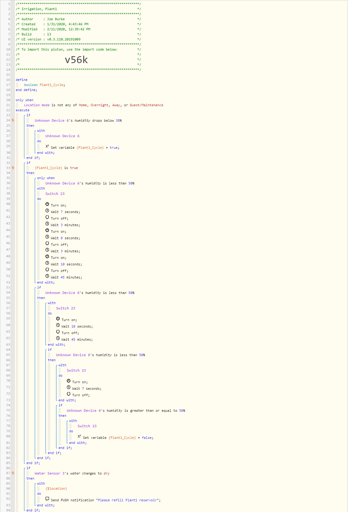

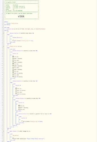

My auto-watering setup for my houseplant: Spruce soil moisture sensor, submerged aquarium pump connected to a smart outlet that pumps to, basically, a small soaker hose coiled around the base of my house plant. I’m having issues with the piston running through to completion (or at least how I intend it to complete).
Only when mode indicates I am home and water sensor indicates wet resevoir: When soil mosture drops below 38%, I want the pump (outlet) to turn on for a certain number of seconds and wait for 3 minutes- and complete that cycle 3 times (to allow water to soak into the soil before adding more). Then wait 45 minutes and check to see if the soil moisture is below 50% (does it need more water?). If yes, water for 10 seconds and wait another 45 minutes. Check again if soil moisture is below 50%. If yes, water for another 7 seconds. If soil moisture reaches 50% OR all the watering cycles have completed, piston ends (to avoid accidental over-watering or overflow in case of faulty sensor or something). When soil mositure drops below 38%, trigger the whole process again.
Watering begins, as expected, when moisture drops below 38%. However, as soon as moisture exceeds 38%, the entire piston stops. I basically want the piston to say, "OK, once the moisture drops below a certain level, do all these things regardless of whether it rises to 39%, 40%, etc. When moisture is below 38%, check and water until it hits 50% or you’ve exhausted all the 50% checks I’ve told you to make.
I’m guessing it’s an issue with my code structure or use of triggers and conditions.
Sorry, at work so don’t have the logs set right now.
