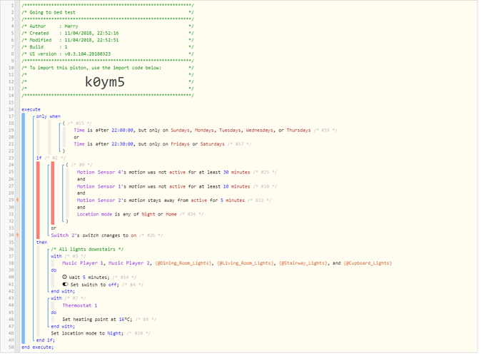

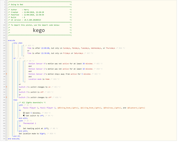

I want Location Mode to change into Night mode automatically. It’s not…
When the three motion sensors have had no motion for at least the specified time (different amounts because they’re in different places), I want all the downstairs lights (as defined by global variables) to turn off, and the speakers downstairs, Nest to drop to 16 deg and finally mode to change to night.
The ‘Then’ part happens, just I struggle to get it started, I created a virtual switch to force it over which works most of the time… :confused:
Is it not working because it’s trying to complete all the motion sensor ones first??
I played around with it to this:
my logs are as below:

shouldnt need a virtual switch. change ALL 3 motion conditions to:
motion sensor 4s motion was not active for at least X minutes
right now 2 of the motion conditions are was not active for at least X minutes and 1 of them is stays away from active for Y minutes.

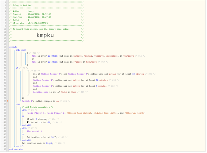

Thanks for your help. I’ve made the change as below. I can keep the Virtual Switch in there can’t I? For testing purposes, or to force it into night mode only?
