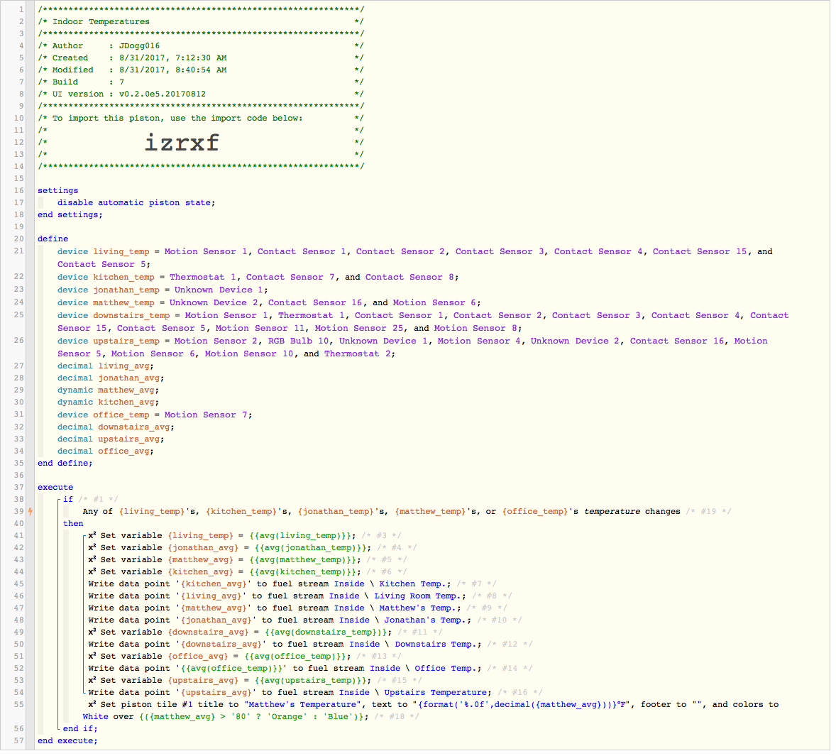

Hi All,
This is my attempt to gather a collection of temperature measurement sensors, average them out, then report them to a fuel stream.
My results seem to be off and I cannot quite tell whether I have setup the piston incorrectly or there are 0’s in the averages no temperature has yet to report to the fuel stream.
In other words, if a contact sensor has yet to change its temperature because the piston has only been active for 30 minutes, would that contact sensor report a 0 thus causing the average to drop?
Alternatively, is this an issue where the temperature is reporting in celsius rather than Fahrenheit?
