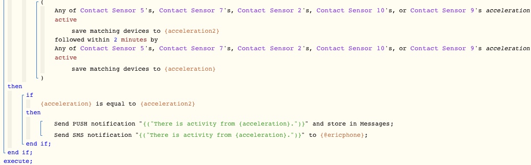

Here is something that I do for my smart things multipurpose sensor’s. They are notorious for showing activity when they are not being active. So if one of them is active, and then the same one is active again with in two minutes I will get an alert.
I won’t get an alert if that sensor is only active one time.
I like your strategy @Eric182, but I would be afraid to use it for security purposes. It is too easy for a crook to unplug the modem, preventing the notification from going thru.
Unfortunately, I do not have any better ideas that do not compromise security.
