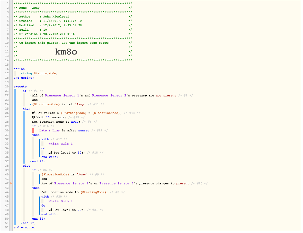

I’m trying to create a piston that will change the location mode to ‘Away’ upon the departure of two people. If they depart and the time is between sunset and sunrise, I also want one of the lights to turn on @ 50%.
I have the away portion working, every time without issue. However, the lighting automation seems to always trigger true once they leave, no matter what the time is. So if they leave the house at 10am, the lights turn on. I’m not quite sure what I did wrong regarding that if statement. I have attached a picture of the piston below. Any help is appreciated!
Is it any different if the virtual device “date & time” on line 30 is changed to just the “time” virtual device?
Try that and give us a full log.
I don’t think line 44 is going to work. You’re using a local variable for StartingMode, but the value of that won’t be saved after the top half of the piston runs and then exits. Thus, StartingMode won’t have a value when line 42 triggers. The bulb should come on, but it’ll stay in Away mode so now the top half of the piston won’t execute when someone leaves. Try a global variable instead.
In my testing, using Date and Time works just fine. So that shouldn’t be the issue.
I agree. Logs would be helpful on this one.
A global variable is only needed if you want to share information between two different pistons. There’s nothing wrong with using a local variable here.
Pistons like this one don’t “run and exit” like a script in other programming languages that you might be familiar with would do. They sit there and “hum along” waiting for the events (triggers) to happen so that they can jump into action. So a value stored in a local variable will still persist after the piston finishes a run through…(because it does not exit…it just goes back to waiting for the next Trigger).

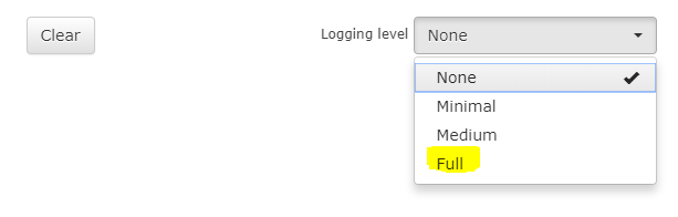

Thanks for the replies…What’s the best way to get the logs? Is there a way other than Live Logging? I only ask since due to the nature of people leaving the house, I may not be available to hit the GUI to get that. Is there anyway to save log specific to that piston somewhere? Or do I just need to leave live logging open on a machine throughout the day?
Yeah, just turn Logging on the piston to Full and let it run. As events happen during the day the piston will keep a log of the things that kicked it off. You can then paste in the results of what you get so we can see what’s going on.

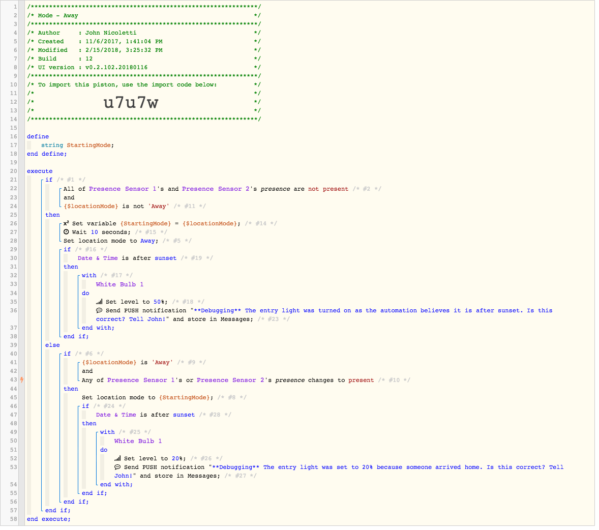

I think I figured it out! After reading it again, slowly I realized that no matter what, the light will turn on @ 20% when they arrive home. They walk in and see the light on and we believe it went on when they left, but that’s not the case. The logic should read to turn the light to 20% if after sunset and they arrive.
I also confirmed this with debugging messages stating which rule triggered (leaving after sunset or coming home). Restructuring the logic and I will report back!
Here is the updated logic, which should now work as intended:
