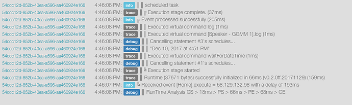

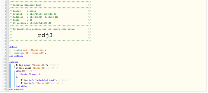

Hello - just need some guidance on the right way to parse an incoming date/timestamp via web hook
delay piston till passed time
time is not being parsed (correctly)

How should it be getting parsed? What are you looking for it to end up as?
that’s part of the question (that I am confused about searching here) it needs to be in a format so that the piston wait until date/time command sees it as valid
It compares date/times in epoch time. Is there a way you can bring in the date time already converted?
Otherwise I think it is probably just trying to compare a date to a string which will just be false
