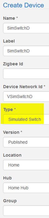

Try using the Virtual Switch DH.
I am not sure if there is a difference between the two, but I have 100% success rate using
Simulated Switches as opposed to Virtual Switches…
SimSwitches work perfectly in webCoRE, ST and IFTTT (as well as Alexa, Google Home and ActionTiles).
No Device Handler required
Forgot about those Simulated Switches. They run local too. :smile:
Type is what I meant by DH. Sort of the same thing isn’t it as this is where custom DH’s appear so that’s how I think of them. :wink:
Good point. I guess I was just trying to clarify that @Tasmin doesn’t have to install anything extra. (this is how I think of DHs, LOL)
