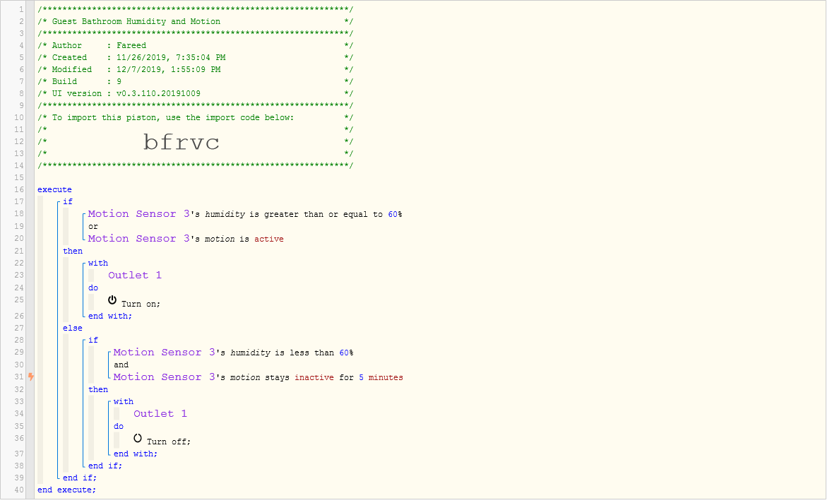

(Even after the humidity and motion and within limits the switch does not turn off)
(after the humidity go to below 60% and the motion is inactive for 5 minutes the switch should turn off)
(Switch stays on even though bot humidity and motion parameters are met)
)5) Attach logs after turning logging level to Full

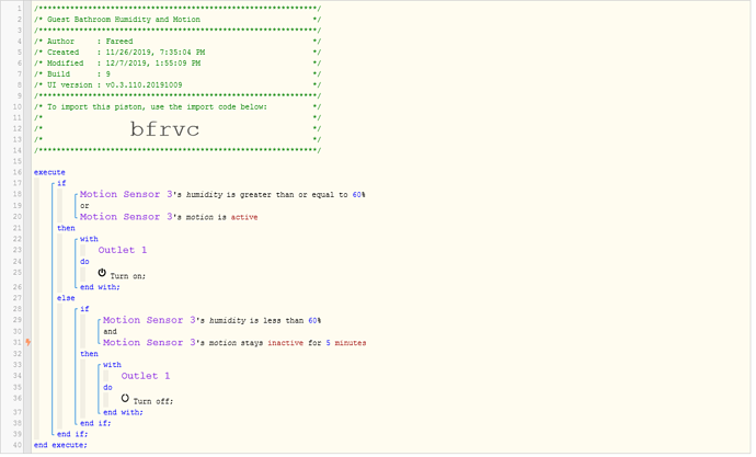

( |+0ms|╔Received event [Guest Bathroom ZSE40 Sensor].motion = inactive with a delay of 55ms|
|+113ms|║RunTime Analysis CS > 17ms > PS > 50ms > PE > 47ms > CE|
|+116ms|║Runtime (38592 bytes) successfully initialized in 50ms (v0.3.110.20191009) (115ms)|
|+117ms|║╔Execution stage started|
|+127ms|║║Comparison (integer) 60 is_greater_than_or_equal_to (integer) 60 = true (1ms)|
|+129ms|║║Condition #2 evaluated true (9ms)|
|+130ms|║║Condition group #1 evaluated true (state did not change) (9ms)|
|+132ms|║║Cancelling statement #3’s schedules…|
|+137ms|║║Skipped execution of physical command [Guest Bathroom Switch].on([]) because it would make no change to the device. (2ms)|
|+138ms|║║Executed [Guest Bathroom Switch].on (4ms)|
|+140ms|║╚Execution stage complete. (24ms)|
|+141ms|╚Event processed successfully (141ms)|
|12/7/2019, 2:13:43 PM +880ms|
|+1ms|╔Received event [Guest Bathroom ZSE40 Sensor].motion = active with a delay of 60ms|
|+148ms|║RunTime Analysis CS > 18ms > PS > 81ms > PE > 48ms > CE|
|+150ms|║Runtime (38590 bytes) successfully initialized in 81ms (v0.3.110.20191009) (148ms)|
|+151ms|║╔Execution stage started|
|+163ms|║║Comparison (integer) 60 is_greater_than_or_equal_to (integer) 60 = true (1ms)|
|+164ms|║║Condition #2 evaluated true (9ms)|
|+165ms|║║Condition group #1 evaluated true (state did not change) (10ms)|
|+167ms|║║Cancelling statement #3’s schedules…|
|+173ms|║║Skipped execution of physical command [Guest Bathroom Switch].on([]) because it would make no change to the device. (2ms)|
|+174ms|║║Executed [Guest Bathroom Switch].on (4ms)|
|+176ms|║╚Execution stage complete. (25ms)|
|+177ms|╚Event processed successfully (177ms)|Preformatted text)
