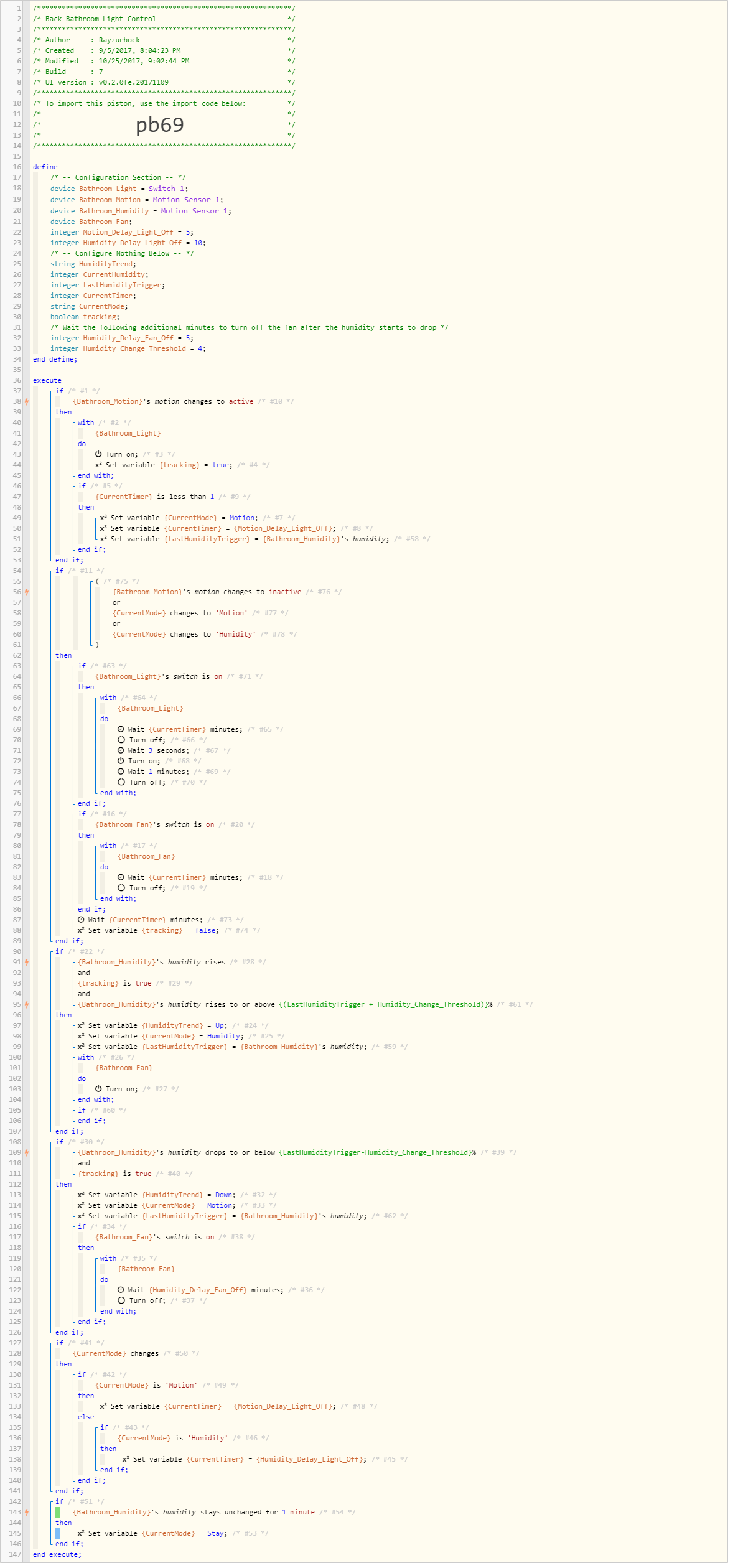

You need a motion sensor, humidity sensor (can be incorporated in the motion sensor), light (optional), and fan (optional). You need to disable any other light/fan controls for the target area.
Bathroom light should turn on based on motion.
Bathroom light should turn off after a delay based on absence of motion.
Bathroom light delay should be extended if the humidity rises rapidly (Shower is in use).
Bathroom fan should turn on if the humidity rises rapidly (Shower is in use).
Bathroom fan should turn off after a delay once the humidity drops (Shower is no longer in use).
This is primarily based off of my SmartThings SmartApp “Bathroom Light Control” but reincarnated as a WebCoRE Piston.
It is working for me, before posting in the Example Pistons, I’d like feedback/testing/confirmation.
I do not have a fan switch but have tied “fan” to a lamp for testing. Seems to work ok for me.
I have none to complain about so far
Hey there, this works great for me. Wondering how I would go about adding a Time condition? We like this bathroom light to turn on 10% between 10PM and 6AM and 100% all other times. And of course 100% when someone is in the shower regardless of the time.
