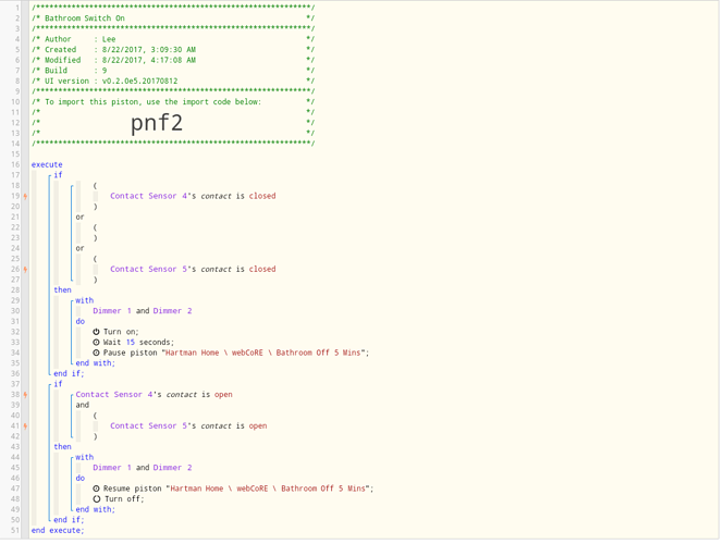

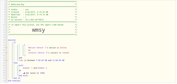

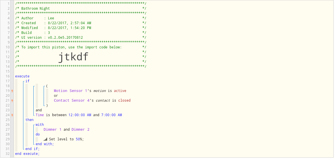

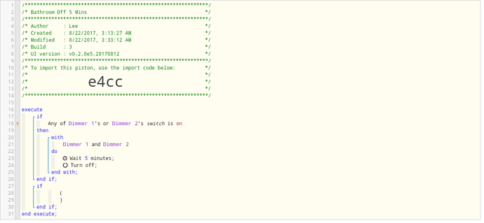

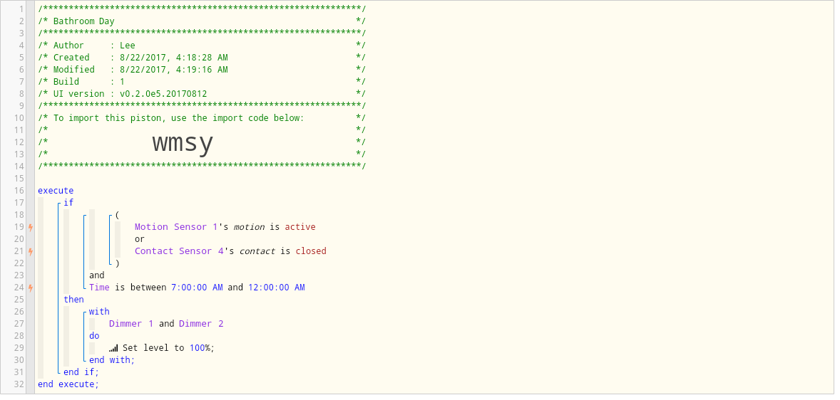

I am hoping I might be able to get some help. I have a contact sensor on the bathroom door, as well as a motion sensor and an actual switch(contact sensor). I want to have the bathroom lights turn on when any of the 3 are closed/active. If just the motion is used to turn the lights on, then I want a 5 minute timer to start to turn the lights off. But when the door is closed or the switch is closed, I want the timer to be paused/cancelled and the lights to remain on. After the door is opened, I would like the timer to resume but if someone goes back into the bathroom I would like the lights to remain on until there is no motion/activity. I also like the idea of the switch completely canceling all and not turning the lights off until the switch is off. I am in the process of switching from core to web core. Previously, everything worked great but the light would turn off if say someone walked into the bathroom, but didn’t close the door until a few minutes after the light turned on.
You could do this in one piston instead of several.
That would be great. I guess I still don’t understand the conditions and flow of the piston. I was never good at coding and this reminds me of it.
Let me see if i can throw together an example. Your pistons (bathroom day and bathroom night) don’t have a trigger. Get rid of “is” and choose “changes to” in the first part.

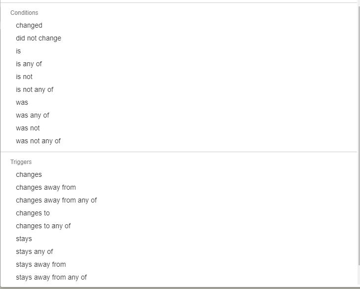

All of these pistons should work as written if you get rid of “is” and use “changes to” instead. “Is” is for status of supplemental items, but you need an action to make them fire. If you look the options are sorted according to action and other.

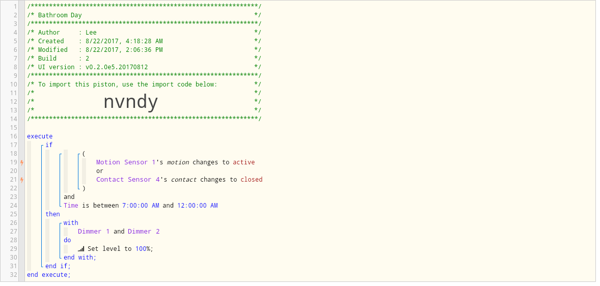

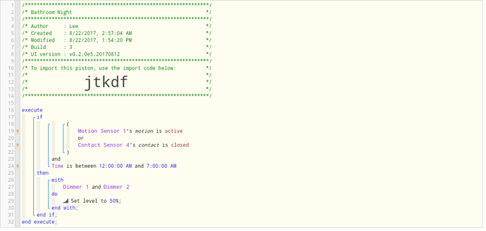

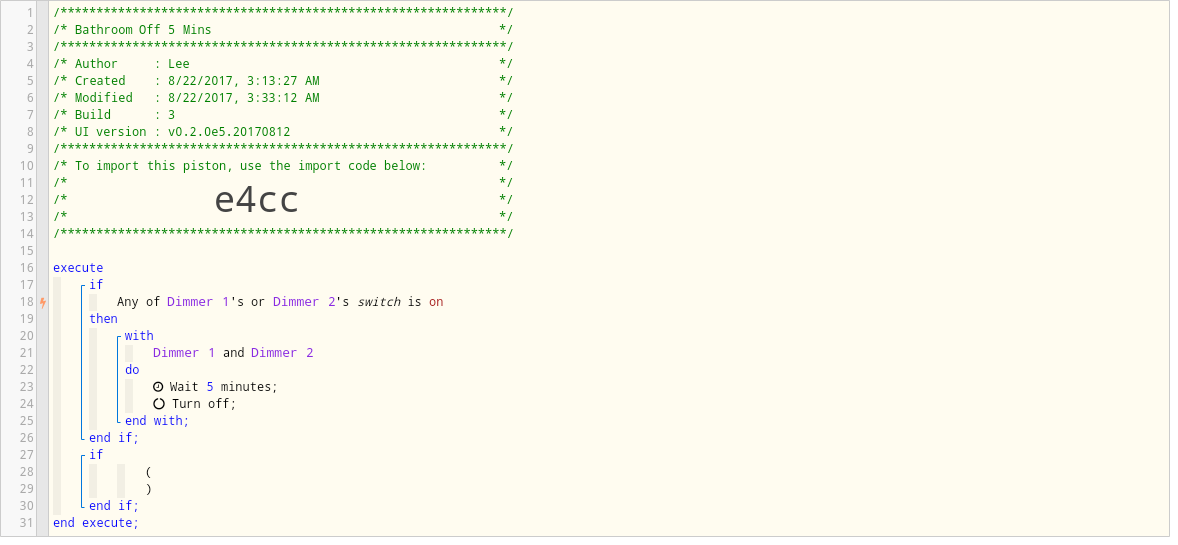

Thank you for the suggestions. I changed both of them from is to changes to.
You talk about an actual switch. You should use switch changes to on for that one. Not contact sensor.

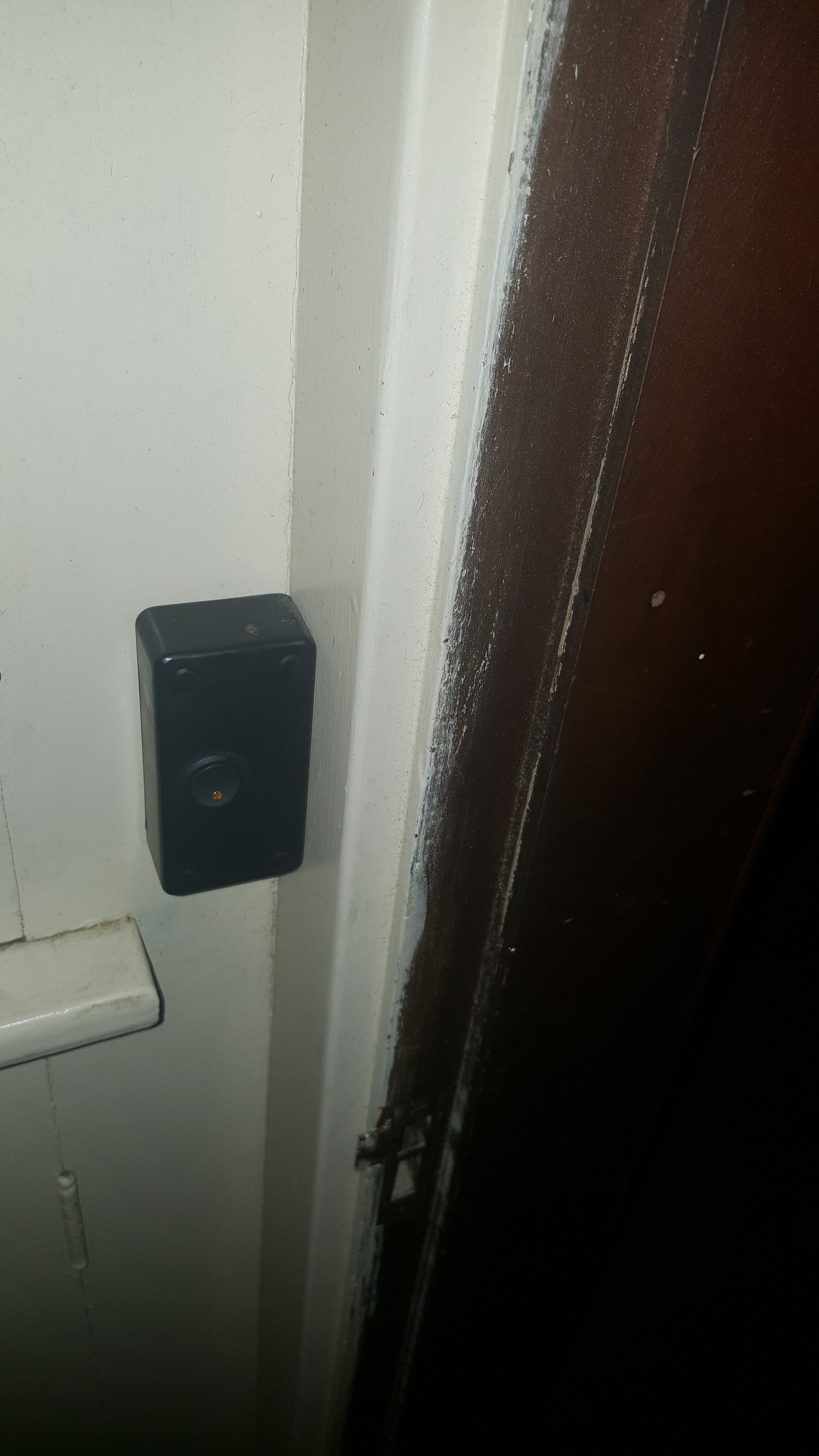

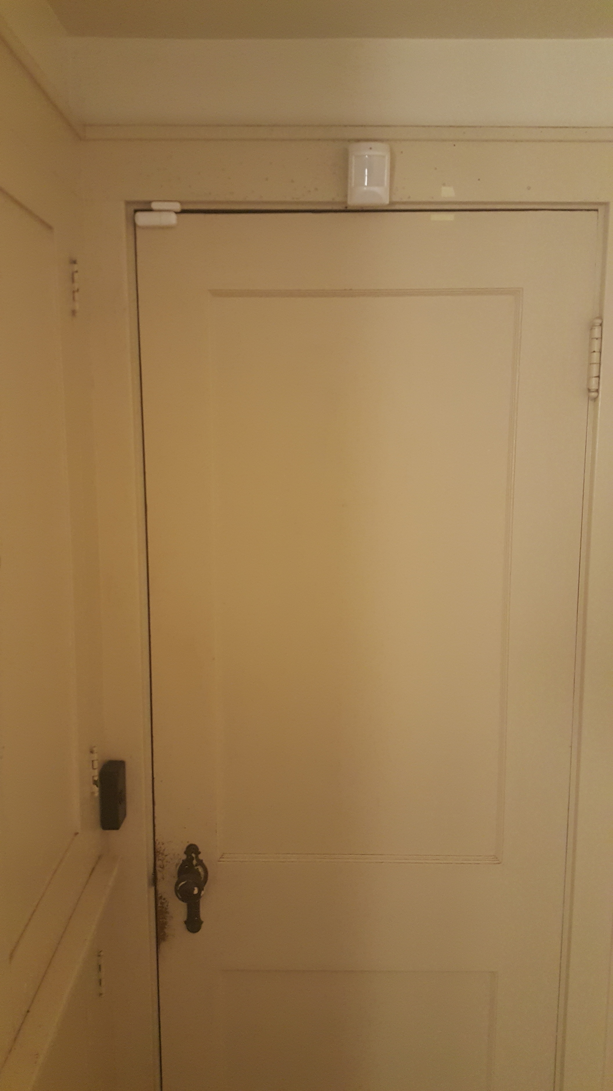

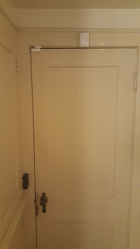

I use a contact sensor with a switch wired to it as a physical switch to turn the lights on and off. This makes turning the light on easier than trying to navigate the dark bathroom where the pull chain switches are located on the light fixtures.
Then I have a contact sensor and motion sensor above the door.

I edited a post above where some bad info was passed. A piston with only a condition of “is” will still execute the piston when the door opens.

You are saying that conditions can’t be used to execute a piston and that is wrong.

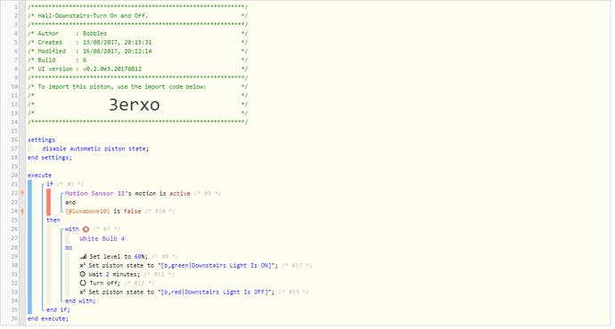

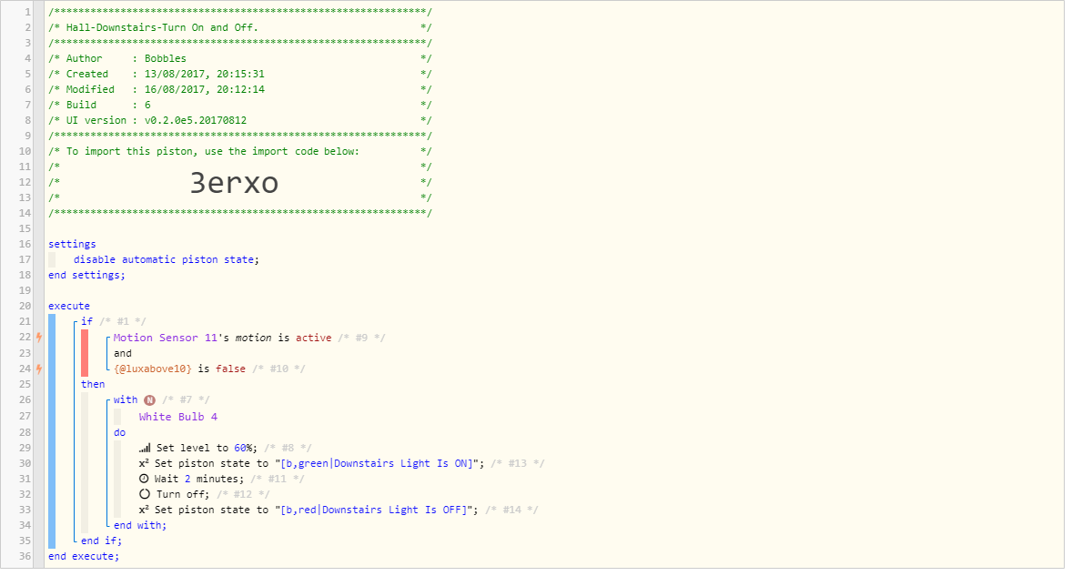

Here is the sort of thing I mean.
#19
“is” is listed under conditions not triggers. Original intent to refer to other contributing conditions. Because of this, I do not believe that “is” can be reliable. Especially if they take this piston and make it more complex. Since I believe that the original poster has an intent to create a complex piston as it would make sense, the piston will be flawed because there will be too much going on. And therefore I don’t feel that editing my post was justified as it was not “bad” information. I’ve built simple pistons with “is” and found that using “is” had become a crapshoot. I dumped using “is” as a main trigger after my second failed piston. Since everyone builds their pistons differently and there is not really a “wrong” way, per se. I thought that move was a bit bold on your part. (c1arkbar) Besides I kind’ve feel that if this forum is going to end up edited for information that you feel is “bad”, maybe I don’t want to contribute anymore. You definitely could have handled it better. Not to create a debate or anything.
