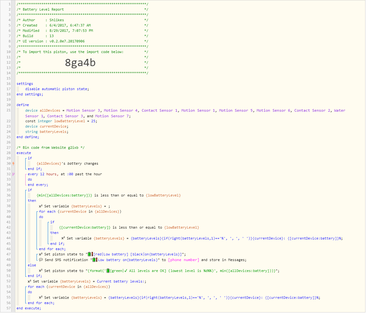

I imported this piston from another member and something seems to be off since I have 2 Arlo Pro batteries much lower than 65, in fact one battery level is down to 41% yet the Piston is showing the lowest is 65%

Have you double checked that you have added all the battery’s that you want to monitor into the alldevices variable? And that there are no devices in that variable that don’t use batteries?
Another thing to check.
Is the discrepancy of levels the Arlo app and what webcore displays?
Hello again,
The alldevice variable is correct
The Arlo app says my batteries range from 37% to 85%, and the ST app says 65%-85%
My guess is the ST app is wrong therefore WebCore is only reporting what it is seeing through the integration point.
I am not using any custom DTH
Thoughts?
