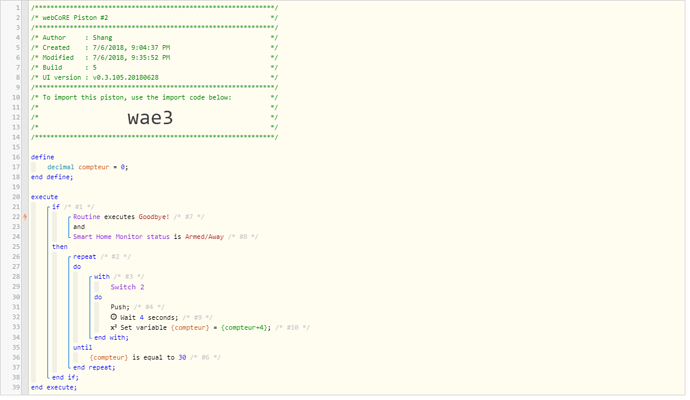

I am using SHM Delay Version 2.0. I have a piezo connected to Konnecteed board. I want to beep the piezo on delays (30 seconds).
Beep every two second when delay is on.
I used a for loop to beep every 2 second, but it beeping very fast.

I am not at my computer now to fully examine this, but my first observation is the beep is happening approximately every 26 milliseconds… (every two seconds will be about 80 times slower)
Shouldn’t there be some kind of delay in your loop code?

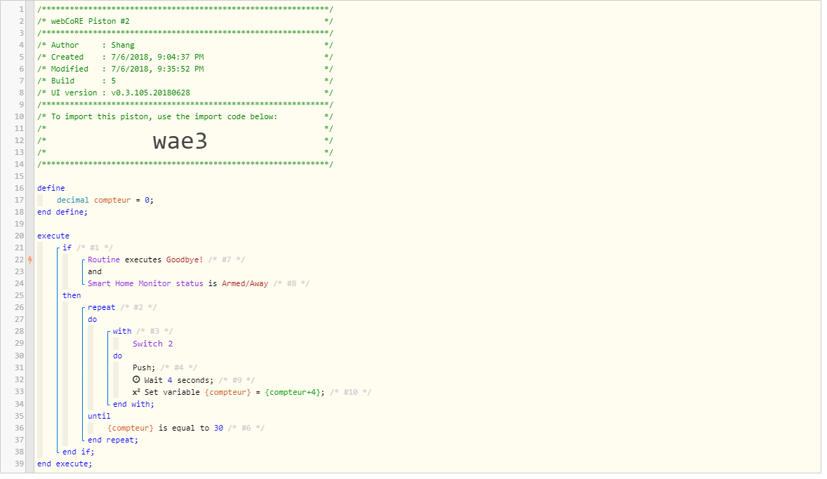

I just updated my code, but it keep beeping. I have a counter, but it never increment.
I am by no means an expert on loops, but 4+4+4 etc will never equal 30…
Perhaps you meant: Until variable is GREATER THAN 30
