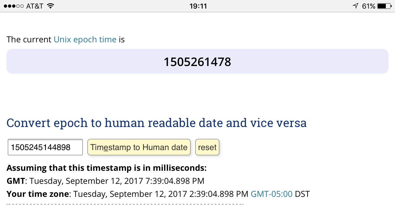

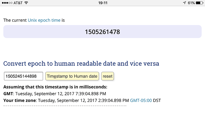

are those even valid timestamps … seems kind of large? :slight_smile:
maybe groovy does not use epoch.
Edit:
From
https://www.epochconverter.com/
epoch in milliseconds … nice! :slight_smile:
i think this is the link for posterity:
thank you.
