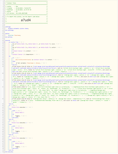

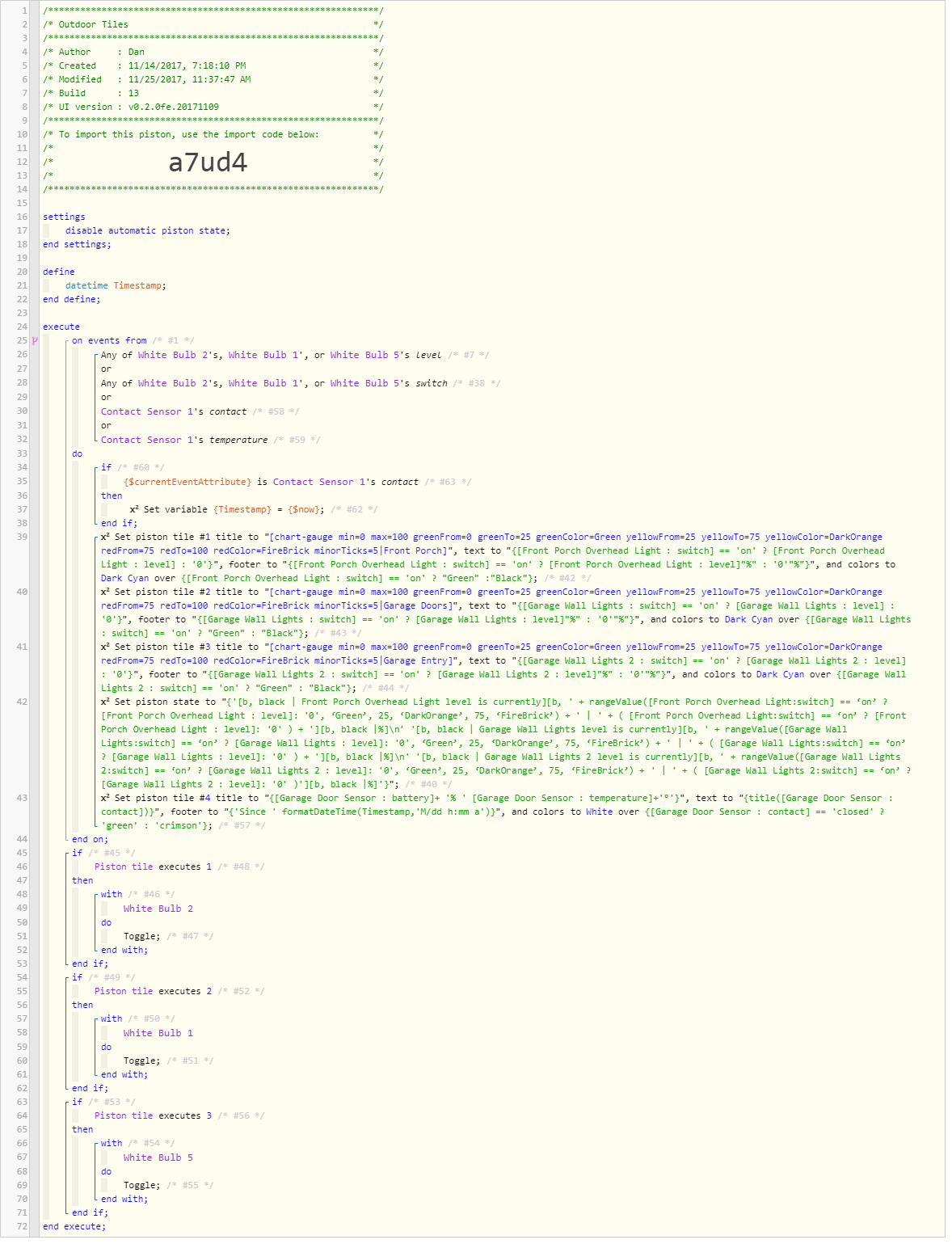

I’m trying to get a variable to update with the current time when my garage door opens or closes. Instead, the variable updates every time the piston runs because the variable $currentEventAttribute (and every variable like it) are always null.
I’ve tried writing this as “if Contact Sensor 1’s contact changed within the last 1 minute” as an alternate, but that evaluates as false every time too.
Is there something in webCoRE I need to enable to start using these variables? They seem very helpful in cutting down on nested IF’s and variables if I could get them to work.
When this piston is executed by a change in Contact Sensor 1 contact, update Timestamp.
Timestamp is updating every time the piston runs.
Logs will be very helpful in this situation. You could also try logging to console the $currentEventAttribute so you can see what it is exactly posting while you gather logs.
Thanks! I’ll pull some logs together for this later today - I just thought maybe there was a known step to take in the configuration of webCoRe that I overlooked to make these work.
I forgot I still had this running without edits, so I have some activity from just now… both from Temperature change [should not affect Timestamp variable] and garage door open/close [should affect Timestamp variable].

Ugh, I think I just figured it out. The $currentEventAttribute is ‘contact’. But selecting the physical device [Contact Sensor : Contact] actually gives its value… ‘closed’ instead. It’s looking for ‘contact’ which I’ll just have to put in as a string to make this work.
Is there a way you know if to select an attribute from a list or is it best just to go with manually typing out the string?
Maybe it’s the device handler giving out the wrong info (Contact vs contact), probably just go with manually typing it unless you’re comfortable digging into device handler code :slight_smile:
