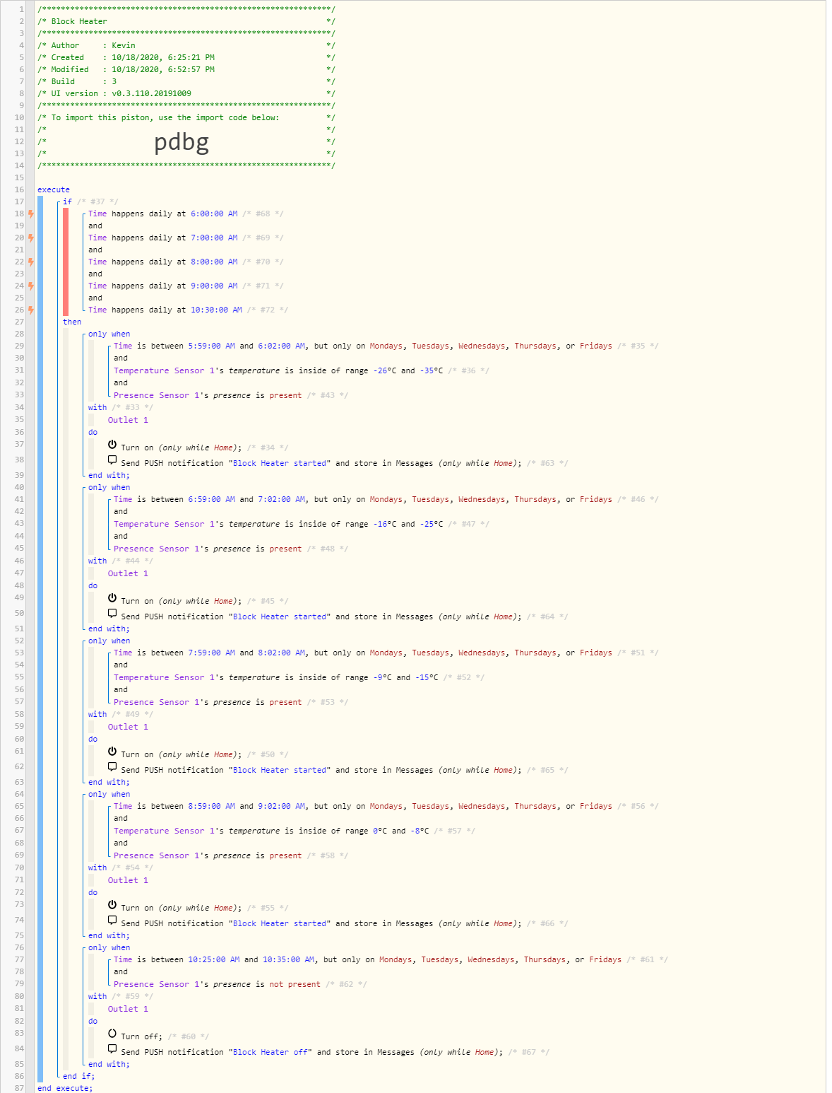

don’t have a specific problem but rather I’m trying out webcore for the first time and wondering If I have the concept right. I’m having a little trouble grasping the ways we would know if a script will or won’t fire. I have one based on various times + temps and there may be a better or proper way to acomplish this. The main idea is that if I am home the block heater turns on in the morning based on the temp. Colder temp range = earlier start time, between certain times it shuts off if I have left the property.
This piston will only execute when “Presence Sensor 1” changes…
(notice the lightning bolts in the left margin)

I have log turned on now, I think I have to wait for tomorrow morning for the log to fill with results though, current version for the time being:
I haven’t examined the whole piston yet (walking out the door ATM)…
… but lines 19, 21, 23, and 25 all need to say "OR.
I would also convert your “ONLY WHEN's” into conditional IF’s, as shown in my 2nd example above.

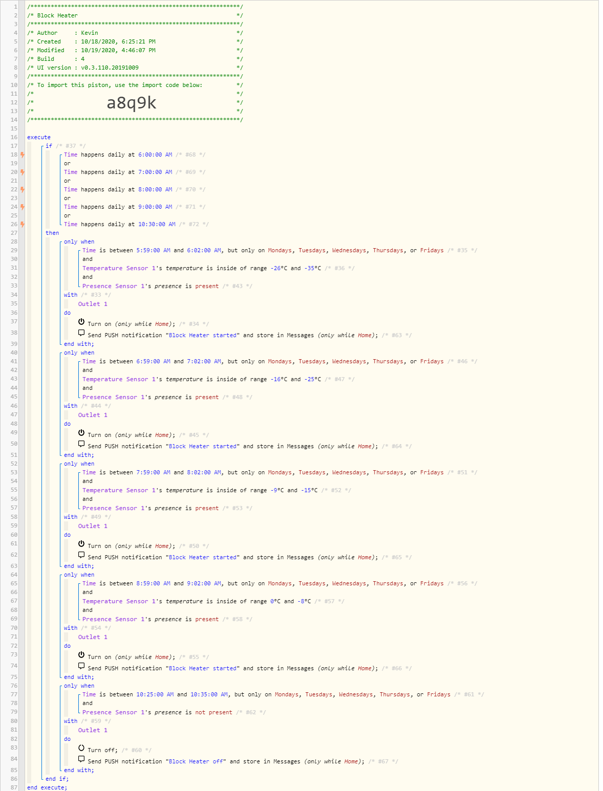

I’ve converted the ANDs to ORs, any advice if its possible to change the Only whens into IFs without rebuilding the chain?

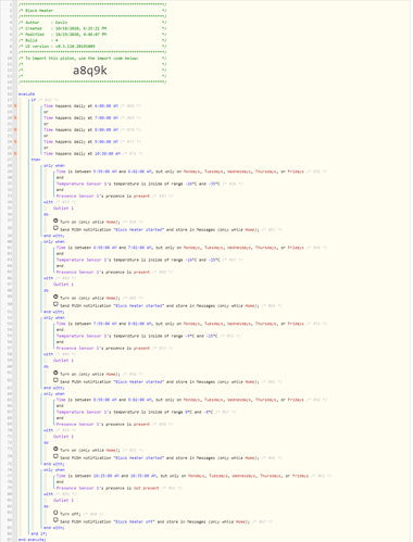

Current version, almost fully working, the start up worked but the shut down did not fire

If you stick with “ONLY WHEN”, I would not expect 100% reliability,
(notice that nothing was checked at 10:30:36 AM)
Using a conditional IF (indented) will force that data to be checked at that time.
(same with all the other blocks above, although you got lucky with your first test)
Edit:
It did not turn off this time because it’s difficult to be “not present” (line 79) and “home” (line 84) at the same moment.
