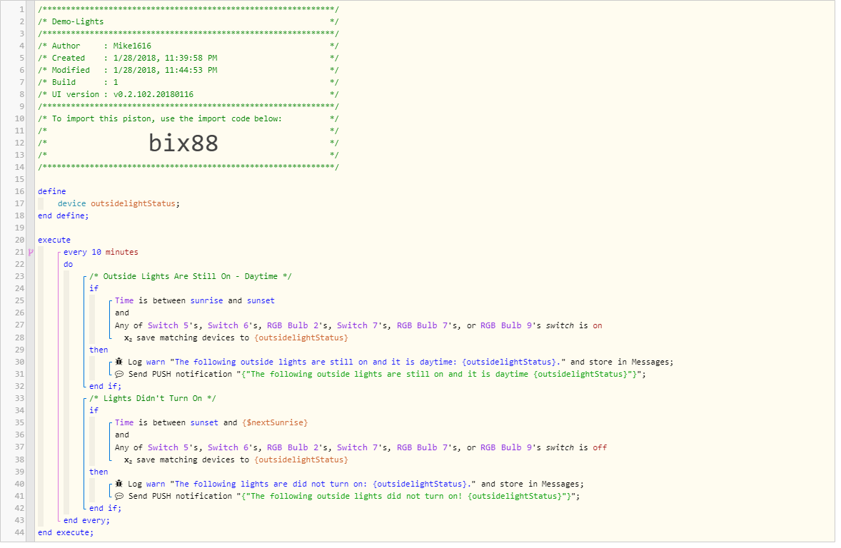

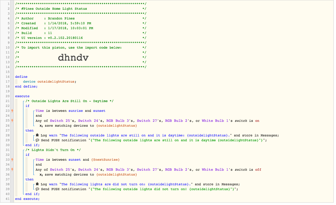

I would like this piston’s if to remind me if the light(s) are not on or off
Push notification every x time until it is turned off
Not sure how to do this

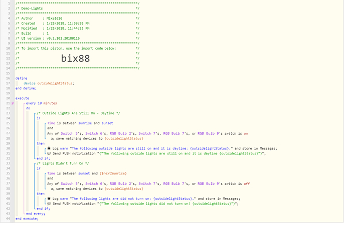

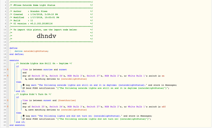

How would I add the Every + Do (lines 21 -22) to my existing piston? I can use your code (thank you) but i’m curious how I can add it to my existing one.
You just add in a Timer and drag everything inside of it. That’s all I did.
