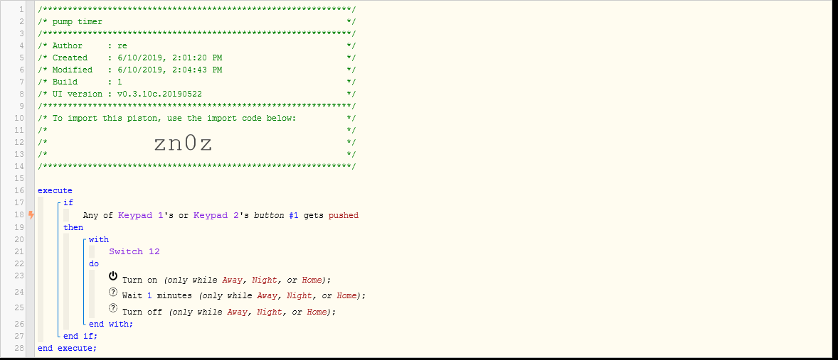

trying to make a piston the either of my 2 Xiaomi Zigbee Aqara Button will turn on a GE outdoor outlet for 1 minute and turn off
using the psychical button it will not trigger the piston, but with the push button option in Samrtthings classic will trigger the piiston fine

Does the ST DTH reflect that you are pushing the button?
maybe the button is disconnected…
Try testing the button…
@logeox @ike2018
yes in Graph.api.sma… the button is connected and showing the time i press it
I can just recommend a test…
1 - I’d try - just to test it - changing ONLY WHILEs maybe someting is happening with the MODEs
2 - REMOVE the button from everywhere and add it back (worked many times for other devices in my house LOL)
