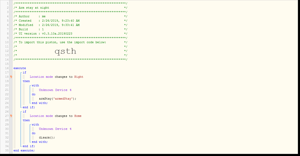

I can use armAway(‘armedAway’) to arm everything.

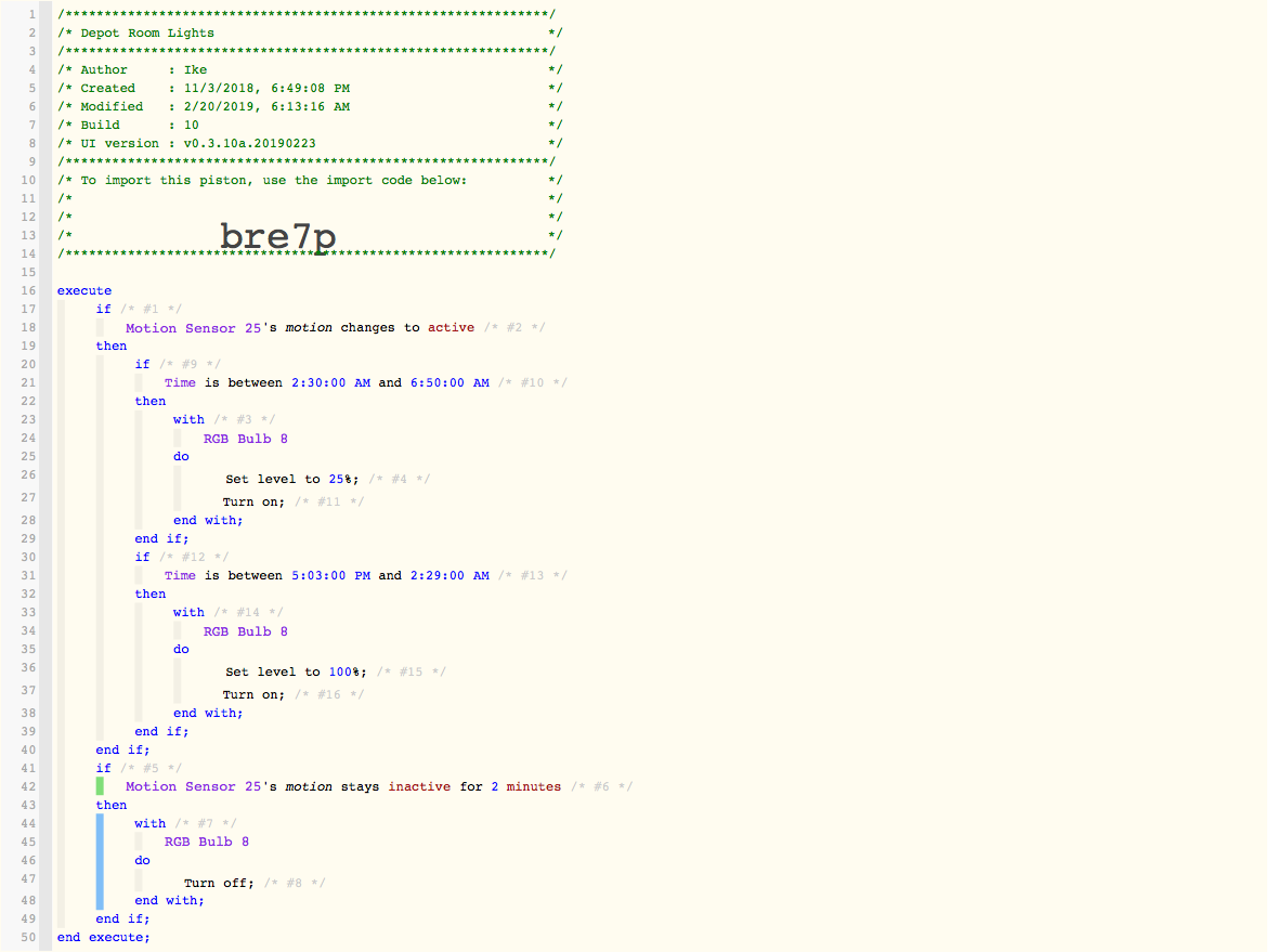

Basically you cant just by pass motion sensors. Meaning motion sensors always WILL report to ST HUB (or what ever your hub is) what you do is, add a condition and play with that condition and even if sensors report back, the house will repond differently.
This is for a small room. as you can see notion sensors will always be triggered but house respond differently due to conditions;

But this will not work. again once you arm, it will trigger all motions sensors, the bypass of sensors needs to happen as parameter to the arm command.
