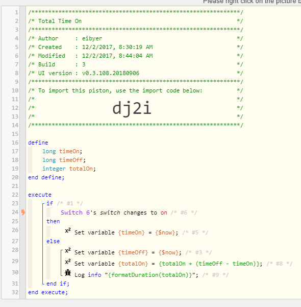

i am trying to record and calculate the average time that motion alerts remain active.
I can record the number of activations (count) and duration of a motion alert (elapsed) but I am struggling to record the total elapsed time. I have defined local variables to record the activation count, the elapsed time of the latest activation but struggling to record the total ongoing elapsed time.
time start;
time elapsed;
int count;
record $now at event activation -
set variable {start} = {$now};
Then when event has finished -
set variable {count} = {count + 1};
set variable {elapsed} = {$now - start};
Then I want to add the elapsed to a running total variable.
set variable {total} = {total + elapsed}; but this doesnt work due to type issues
An error occurred while executing the event: groovy.lang.GroovyRuntimeException: Could not find matching constructor for: java.util.Date(java.lang.Double)
I am doing this so I can set the delay to the average, wait {total / count};
What type do I need to define to store the total running elapsed time?
Suggestions are welcomed on this…
