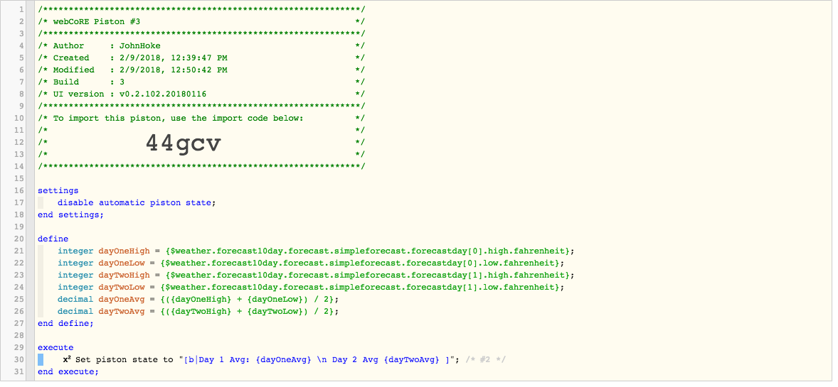

Unfortunately Wunderground’s api is not always ideal (as I have learned with my roof heater piston) … so…
using what is available here: https://wiki.webcore.co/Weather I through this together … I only did two days but should get you going … and I am postiive there is a more elegant way to do this :slight_smile:

Today:
$weather.forecast10day.forecast.simpleforecast.forecastday.high.celsius[0]
Tomorrow:
$weather.forecast10day.forecast.simpleforecast.forecastday.high.celsius[1]

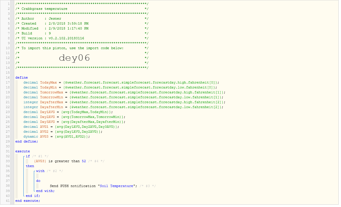

Thanks. I think I got the calculation to work. Now I want the piston to run and send me a text if the final average is above 52F.
example: Temperature is 54.1F.

This is what I have. I will see how this works. Anyway for webcore to message me Soil temperature is ‘avg3 value’?

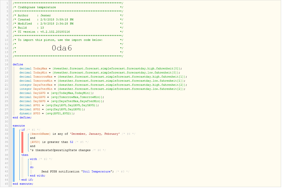

something looks off with your last and condition … is that right?
#15
I had to involve my thermostat else the piston wasn’t going to run on its own. So now every time my thermostat is idle/heating/cooling it does the temperature calculations.
