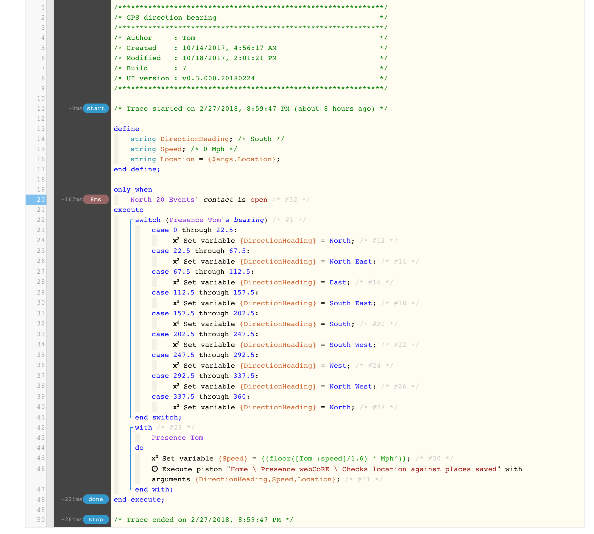

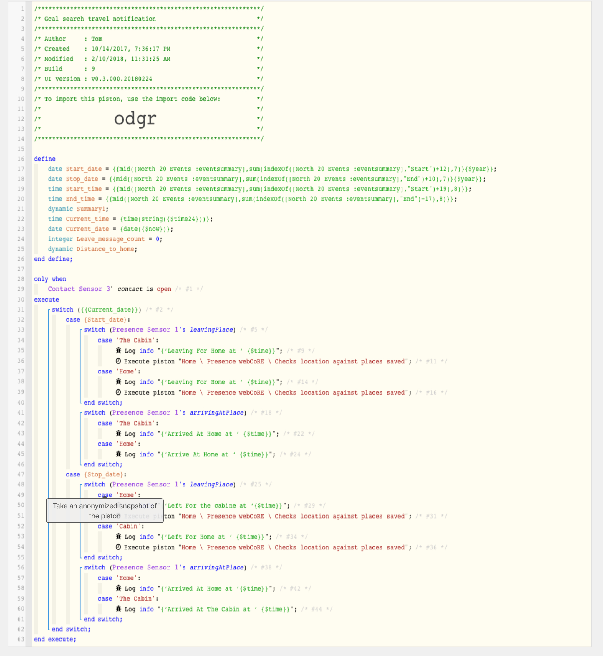

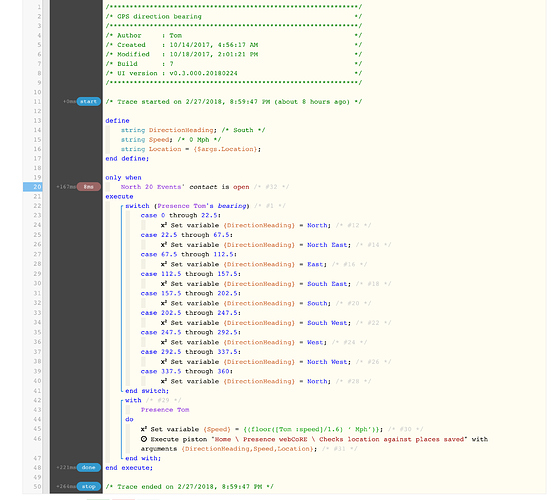

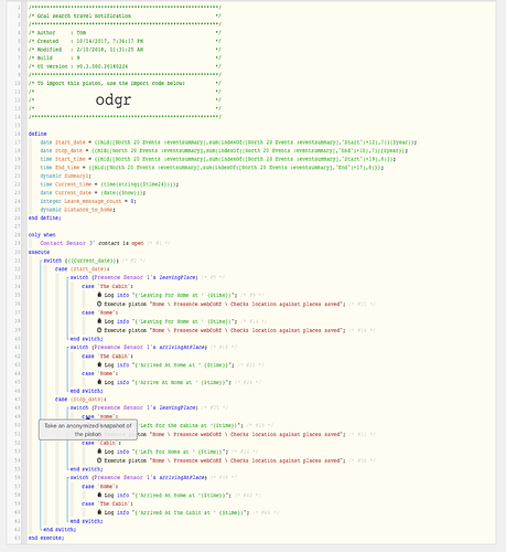

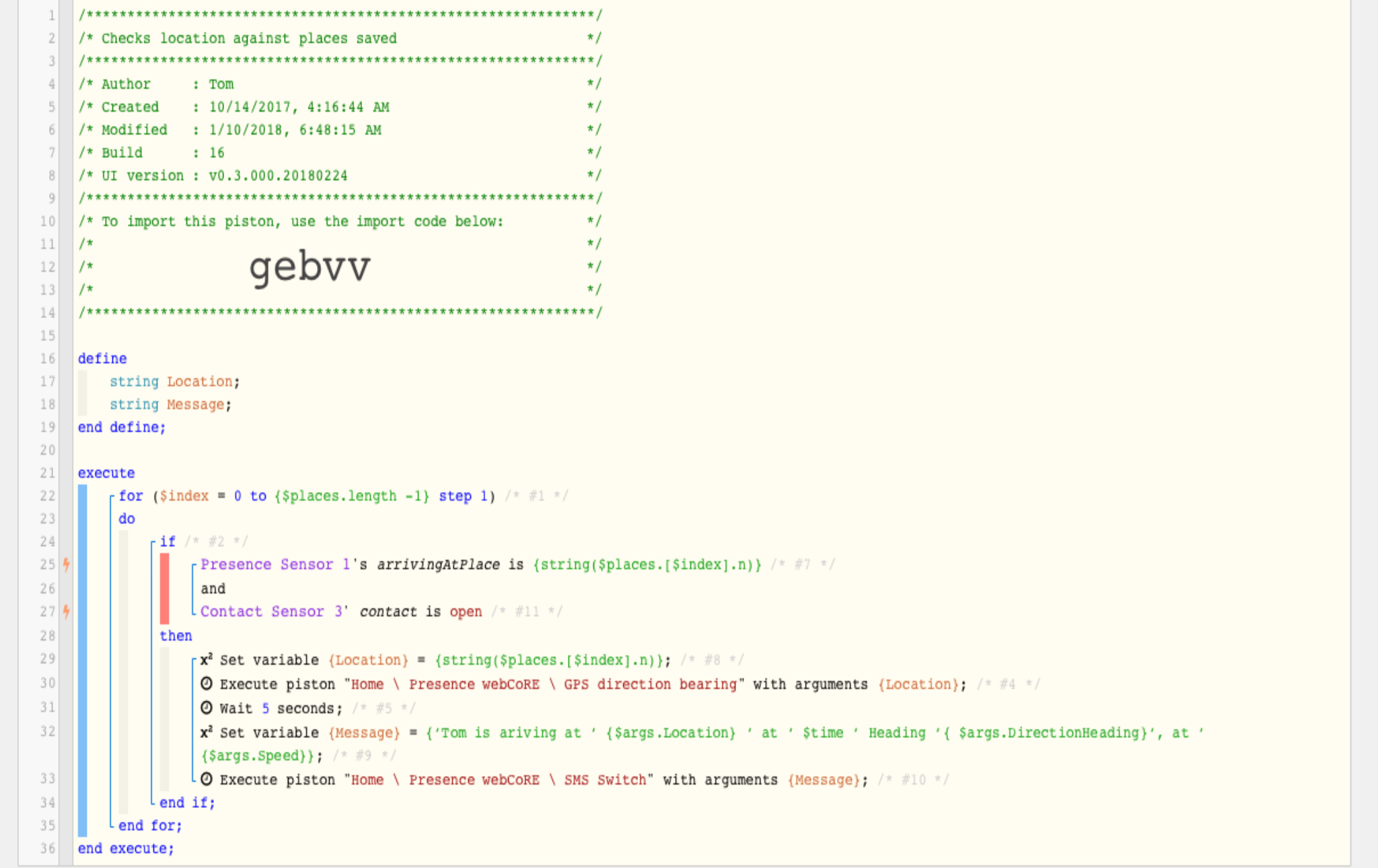

Sure This is the ones I use for traveling
They send notifications to my wife when I get to certain citys(places), this way she knows I am ok. And I, as forgetful as I am, don’t forget to send he a message when I arrive
It’s broken up into3 pistons, first one checks the gcal stuff to see if calendar event is started the nex 2 Check’s places and the direction and speed I am moving at. There is a 4th one that I didn’t include as that is just the sms message one with information about my travel direction. Speed and city at
