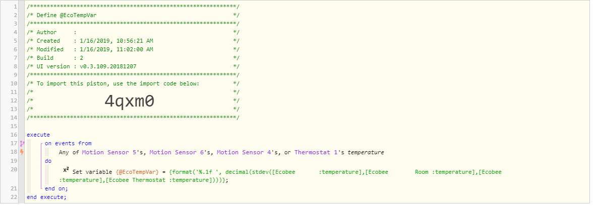

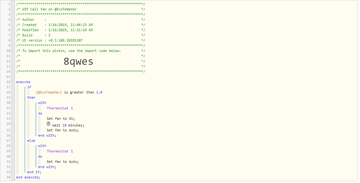

Its more efficient to run the HVAC fan to equalize temps throughout the house (even without firing the gas furnace), so I am trying to make that happen intelligently.
When the temp imbalance is too large the HVAC fan will run for 10 minutes then go back to auto - only run with a call for heat from the Ecobee.
I have set the Ecobee “minimum fan run time per hour in Auto” to 0 mins in the Ecobee GUI, so the fan should only run with Ecobee calls for heat or when Webcore triggers it.
Nothing.
I can watch the @EcoTempVar climb over the setpoint, but the HVAC fan will not come on.
Also, to confirm - Webcore calling the fan to on / auto shouldn’t conflict with Ecobee3 doings it’s job in regards to heating, right? :crossed_fingers:

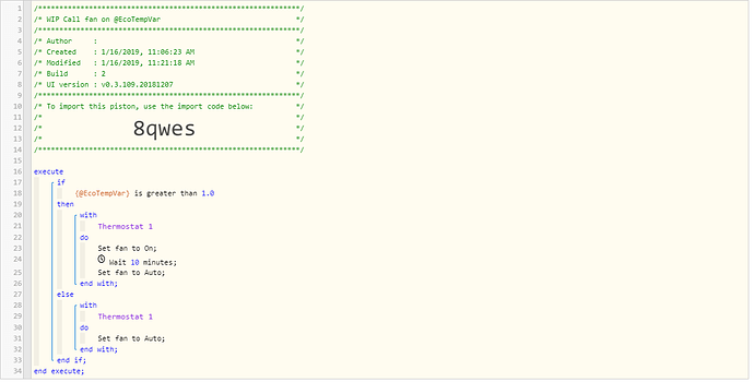

I think line 18 in your “8qwes” piston should be a trigger instead of a condition.
Such as:
IF {@EcoTempVar} rises above 1.0
I’m not sure that I understand what you mean. I did input that as an “If Block” in the piston…?
If you click on line 18 to edit it
temp
there should be a drop down list where it currently says “is greater than”.
My advice was to change that to a trigger such as “rises above”
Oh I see now, thank you. I have updated it and will monitor.
