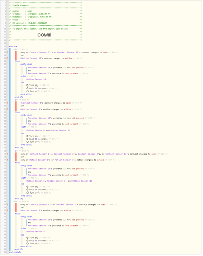

Cams enabling when they are not suppose to
camera
presence
Cams are only suppose to come on if BOTH of us are gone and motion is detected. Instead they come on if EITHER of us are gone. Plus I have the attached odd message in the logs. Any ideas?

I figured this part out… I had not published one of the 4 smartapps… but that was not the problem with the cams coming on when they are not suppose to.
Can you set logging to Full and post that? Can’t tell what’s happening in the piston without that.
Will do… will have to wait till this afternoon for it to happen thou.
Some logs - not sure they help thou…webCoRE
Home \ webCoRE Main (v0.2.101)
Enable Cameras
Status
This piston is currently active and humming happily.
Pause »
Piston category
Motions & Lights
Quick facts
Piston state: false
Last executed: 1/17/2018, 9:48:05 PM
Next scheduled: never
Subscriptions: 13 events, 3 controls
Devices used: 16
Memory used: 73% (73153 bytes)
External URL: (click to open/execute)
Automatic backup
You do not have automatic backup enabled for this piston.
Enable automatic backup »
Script (hide)
/* Enable Cameras */
/* Author : Alan /
Created : 1/9/2018, 1:33:47 PM /
Modified : 1/16/2018, 10:11:30 AM /
Build : 4 /
UI version : v0.2.101.20171227 */
execute
if
Any of y Garage French door’s or y Garage Man Door’s contact changes to open
or
Cam Garage’s motion changes to active
then
only when
Zoila’s phone - wc’s presence is not not present
and
Alan’s phone - wc’s presence is not present
with
Cam Garage
do
Turn on;
Wait 30 seconds;
Turn off;
end with;
end if;
if
y Front Door’s contact changes to open
or
Cam Front porch’s motion changes to active
then
only when
and
with
Cam Front porch and Cam Living Room
do
Turn on;
Wait 30 seconds;
Turn off;
end with;
end if;
if
Any of Garage Door Back’s, Garage Door Center’s, Garage Door Street’s, or y Garage French door’s contact changes to open
or
Any of Cam Driveway Down’s or Cam Driveway up’s motion changes to active
then
only when
and
with
Cam Driveway Down, Cam Driveway up, and Cam Garage
do
Turn on;
Wait 30 seconds;
Turn off;
end with;
end if;
if
Any of y Patio Door Dinette’s or y Patio Door Living Room’s contact changes to open
or
Cam Back Porch’s motion changes to active
then
only when
and
with
Cam Back Porch
do
Turn on;
Wait 30 seconds;
Turn off;
end with;
end if;
end execute;
Edit » Test TraceTrace Delete »

+208ms ║║Condition #17 evaluated false (6ms)
+216ms ║║Condition #18 evaluated false (6ms)
+217ms ║║Condition group #10 evaluated false (state did not change) (14ms)
+236ms ║║Condition #26 evaluated false (17ms)
+247ms ║║Condition #27 evaluated false (10ms)
+248ms ║║Condition group #19 evaluated false (state did not change) (29ms)
+261ms ║║Condition #35 evaluated false (9ms)
+268ms ║║Condition #36 evaluated false (6ms)
+269ms ║║Condition group #28 evaluated false (state did not change) (18ms)
+271ms ║╚Execution stage complete. (95ms)
+272ms ╚Event processed successfully (273ms)
1/17/2018, 9:37:39 PM +807ms
+1ms ╔Received event [y Garage Man Door].contact = open with a delay of 472ms
+183ms ║RunTime Analysis CS > 22ms > PS > 25ms > PE > 136ms > CE
+186ms ║Runtime (48438 bytes) successfully initialized in 25ms (v0.2.101.20171227) (183ms)
+186ms ║╔Execution stage started
+201ms ║║Comparison (enum) open changes_to (string) open = true (0ms)
+203ms ║║Cancelling condition #6’s schedules…
+204ms ║║Condition #6 evaluated true (11ms)
+205ms ║║Cancelling condition #1’s schedules…
+206ms ║║Condition group #1 evaluated true (state changed) (14ms)
+218ms ║║Comparison (enum) present is_not (string) not present = true (2ms)
+219ms ║║Condition #7 evaluated true (11ms)
+229ms ║║Comparison (enum) not present is (string) not present = true (2ms)
+230ms ║║Condition #8 evaluated true (10ms)
+231ms ║║Condition group #2 evaluated true (state did not change) (23ms)
+232ms ║║Cancelling statement #2’s schedules…
+238ms ║║Skipped execution of physical command [Cam Garage].on([]) because it would make no change to the device. (2ms)
+239ms ║║Executed [Cam Garage].on (3ms)
+242ms ║║Executed virtual command [Cam Garage].wait (1ms)
+243ms ║║Requesting a wake up for Wed, Jan 17 2018 @ 9:38:10 PM EST (in 30.0s)
+248ms ║╚Execution stage complete. (62ms)
+249ms ║Setting up scheduled job for Wed, Jan 17 2018 @ 9:38:10 PM EST (in 29.995s)
+260ms ╚Event processed successfully (259ms)
1/17/2018, 9:37:13 PM +81ms
+1ms ╔Received event [Cam Garage].motion = inactive with a delay of 86ms
+9785ms ║RunTime Analysis CS > 18ms > PS > 9641ms > PE > 127ms > CE
+9786ms ║Piston waited at a semaphore for 9623ms
+9788ms ║Runtime (48507 bytes) successfully initialized in 9641ms (v0.2.101.20171227) (9787ms)
+9789ms ║╔Execution stage started
+9805ms ║║Condition #6 evaluated false (10ms)
+9809ms ║║Comparison (enum) inactive changes_to (string) active = false (1ms)
+9810ms ║║Condition #9 evaluated false (4ms)
+9811ms ║║Condition group #1 evaluated false (state did not change) (17ms)
+9820ms ║║Condition #17 evaluated false (6ms)
+9827ms ║║Condition #18 evaluated false (6ms)
+9828ms ║║Condition group #10 evaluated false (state did not change) (14ms)
+9848ms ║║Condition #26 evaluated false (17ms)
+9858ms ║║Condition #27 evaluated false (9ms)
+9859ms ║║Condition group #19 evaluated false (state did not change) (28ms)
+9872ms ║║Condition #35 evaluated false (10ms)
+9878ms ║║Condition #36 evaluated false (5ms)
+9879ms ║║Condition group #28 evaluated false (state did not change) (18ms)
+9881ms ║╚Execution stage complete. (92ms)
+9882ms ╚Event processed successfully (9882ms)
1/17/2018, 9:37:14 PM +474ms
+1ms ╔Received event [y Garage Man Door].contact = closed with a delay of 145ms
+179ms ║RunTime Analysis CS > 20ms > PS > 23ms > PE > 135ms > CE
+182ms ║Runtime (48427 bytes) successfully initialized in 23ms (v0.2.101.20171227) (179ms)
+183ms ║╔Execution stage started
+195ms ║║Comparison (enum) closed changes_to (string) open = false (0ms)
+196ms ║║Cancelling condition #6’s schedules…
+197ms ║║Condition #6 evaluated false (9ms)
+203ms ║║Condition #9 evaluated false (5ms)
+204ms ║║Cancelling condition #1’s schedules…
+205ms ║║Condition group #1 evaluated false (state changed) (18ms)
+213ms ║║Condition #17 evaluated false (5ms)
+220ms ║║Condition #18 evaluated false (6ms)
+221ms ║║Condition group #10 evaluated false (state did not change) (13ms)
+242ms ║║Cancelling condition #26’s schedules…
+242ms ║║Condition #26 evaluated false (19ms)
+254ms ║║Condition #27 evaluated false (11ms)
+255ms ║║Cancelling condition #19’s schedules…
+256ms ║║Condition group #19 evaluated false (state changed) (33ms)
+268ms ║║Condition #35 evaluated false (10ms)
+275ms ║║Condition #36 evaluated false (6ms)
+276ms ║║Condition group #28 evaluated false (state did not change) (18ms)
+279ms ║╚Execution stage complete. (96ms)
+280ms ╚Event processed successfully (280ms)
1/17/2018, 9:37:12 PM +686ms
+1ms ╔Received event [y Garage Man Door].contact = open with a delay of 652ms
+179ms ║RunTime Analysis CS > 15ms > PS > 23ms > PE > 141ms > CE
+181ms ║Runtime (48430 bytes) successfully initialized in 23ms (v0.2.101.20171227) (180ms)
+182ms ║╔Execution stage started
+196ms ║║Comparison (enum) open changes_to (string) open = true (1ms)
+198ms ║║Cancelling condition #6’s schedules…
+199ms ║║Condition #6 evaluated true (10ms)
+200ms ║║Cancelling condition #1’s schedules…
+200ms ║║Condition group #1 evaluated true (state changed) (13ms)
+210ms ║║Comparison (enum) present is_not (string) not present = true (1ms)
+211ms ║║Condition #7 evaluated true (9ms)
+219ms ║║Comparison (enum) not present is (string) not present = true (2ms)
+220ms ║║Cancelling condition #8’s schedules…
+221ms ║║Condition #8 evaluated true (10ms)
+222ms ║║Cancelling condition #2’s schedules…
+223ms ║║Condition group #2 evaluated true (state changed) (20ms)
+224ms ║║Cancelling statement #2’s schedules…
+333ms ║║Executed physical command [Cam Garage].on() (106ms)
+334ms ║║Executed [Cam Garage].on (107ms)
+337ms ║║Executed virtual command [Cam Garage].wait (1ms)
+338ms ║║Requesting a wake up for Wed, Jan 17 2018 @ 9:37:43 PM EST (in 30.0s)
+343ms ║╚Execution stage complete. (160ms)
+344ms ║Setting up scheduled job for Wed, Jan 17 2018 @ 9:37:43 PM EST (in 29.996s)
+352ms ╚Event processed successfully (351ms)
1/17/2018, 9:33:26 PM +823ms
+1ms ╔Received event [Garage Door Center].contact = open with a delay of 100ms
+162ms ║RunTime Analysis CS > 14ms > PS > 21ms > PE > 128ms > CE
+165ms ║Runtime (48436 bytes) successfully initialized in 21ms (v0.2.101.20171227) (164ms)
+166ms ║╔Execution stage started
+183ms ║║Condition #6 evaluated false (12ms)
+189ms ║║Condition #9 evaluated false (5ms)
+190ms ║║Condition group #1 evaluated false (state did not change) (19ms)
+198ms ║║Condition #17 evaluated false (5ms)
+205ms ║║Condition #18 evaluated false (6ms)
+206ms ║║Condition group #10 evaluated false (state did not change) (13ms)
+224ms ║║Comparison (enum) open changes_to (string) open = true (1ms)
+226ms ║║Cancelling condition #26’s schedules…
+227ms ║║Condition #26 evaluated true (18ms)
+228ms ║║Cancelling condition #19’s schedules…
+229ms ║║Condition group #19 evaluated true (state changed) (21ms)
+237ms ║║Comparison (enum) present is_not (string) not present = true (1ms)
+239ms ║║Condition #24 evaluated true (7ms)
+247ms ║║Comparison (enum) present is (string) not present = false (2ms)
+248ms ║║Condition #25 evaluated false (9ms)
+249ms ║║Condition group #20 evaluated false (state did not change) (18ms)
+504ms ║║Condition #35 evaluated false (251ms)
+510ms ║║Condition #36 evaluated false (6ms)
+511ms ║║Condition group #28 evaluated false (state did not change) (259ms)
+513ms ║╚Execution stage complete. (347ms)
+514ms ╚Event processed successfully (515ms)
1/17/2018, 9:33:18 PM +134ms
+1ms ╔Received event [y Garage Man Door].contact = closed with a delay of 415ms
+163ms ║RunTime Analysis CS > 13ms > PS > 22ms > PE > 127ms > CE
+166ms ║Runtime (48433 bytes) successfully initialized in 22ms (v0.2.101.20171227) (164ms)
+181ms ║║Comparison (enum) closed changes_to (string) open = false (1ms)
+183ms ║║Cancelling condition #6’s schedules…
+183ms ║║Condition #6 evaluated false (10ms)
+190ms ║║Condition #9 evaluated false (6ms)
+191ms ║║Cancelling condition #1’s schedules…
+192ms ║║Condition group #1 evaluated false (state changed) (20ms)
+201ms ║║Condition #17 evaluated false (6ms)
+208ms ║║Condition #18 evaluated false (6ms)
+208ms ║║Condition group #10 evaluated false (state did not change) (14ms)
+230ms ║║Condition #26 evaluated false (19ms)
+241ms ║║Condition #27 evaluated false (10ms)
+242ms ║║Condition group #19 evaluated false (state did not change) (31ms)
+254ms ║║Condition #35 evaluated false (9ms)
+261ms ║║Condition #36 evaluated false (7ms)
+262ms ║║Condition group #28 evaluated false (state did not change) (18ms)
+264ms ║╚Execution stage complete. (98ms)
+265ms ╚Event processed successfully (265ms)
1/17/2018, 9:33:15 PM +568ms
+1ms ╔Received event [y Garage Man Door].contact = open with a delay of 546ms
+164ms ║RunTime Analysis CS > 13ms > PS > 22ms > PE > 128ms > CE
+167ms ║Runtime (48435 bytes) successfully initialized in 22ms (v0.2.101.20171227) (165ms)
+168ms ║╔Execution stage started
