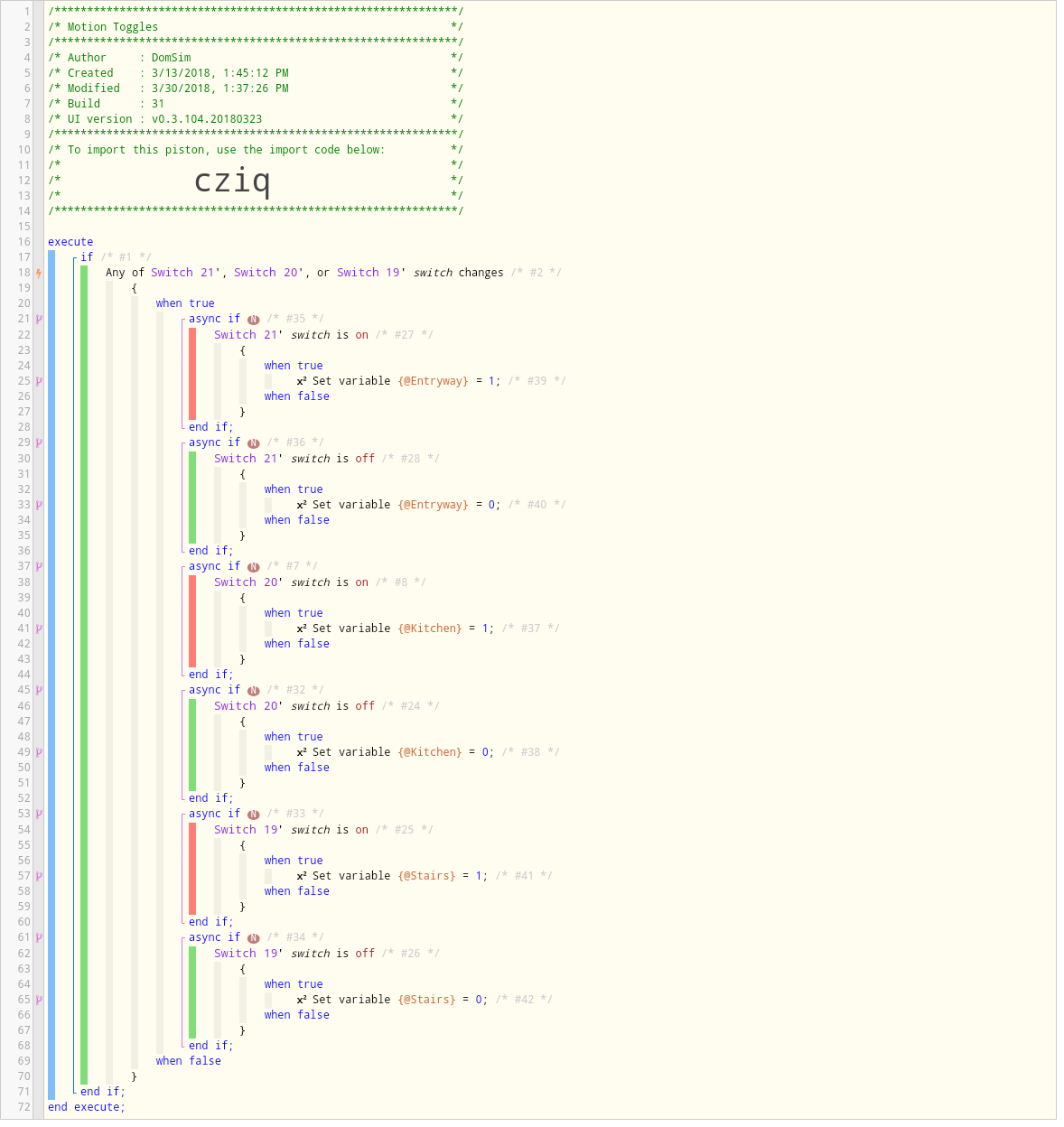

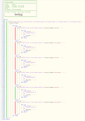

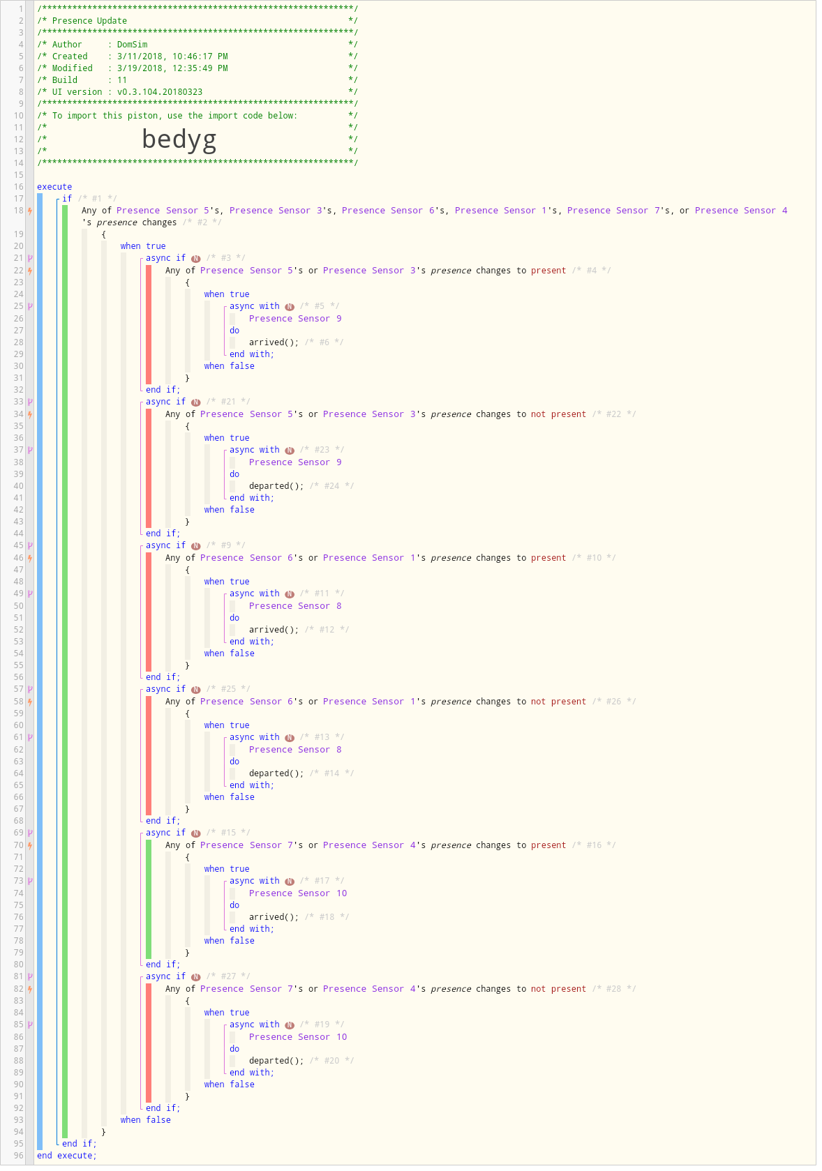

The trick will be setting your conditions to async. That will allow multiple things to execute when the piston is triggered. I have these 2, as an example. One is using multiple presence sensors to update one virtual presence sensor for each person, and the second is for toggling motion controls on and off for the lights in my house.
