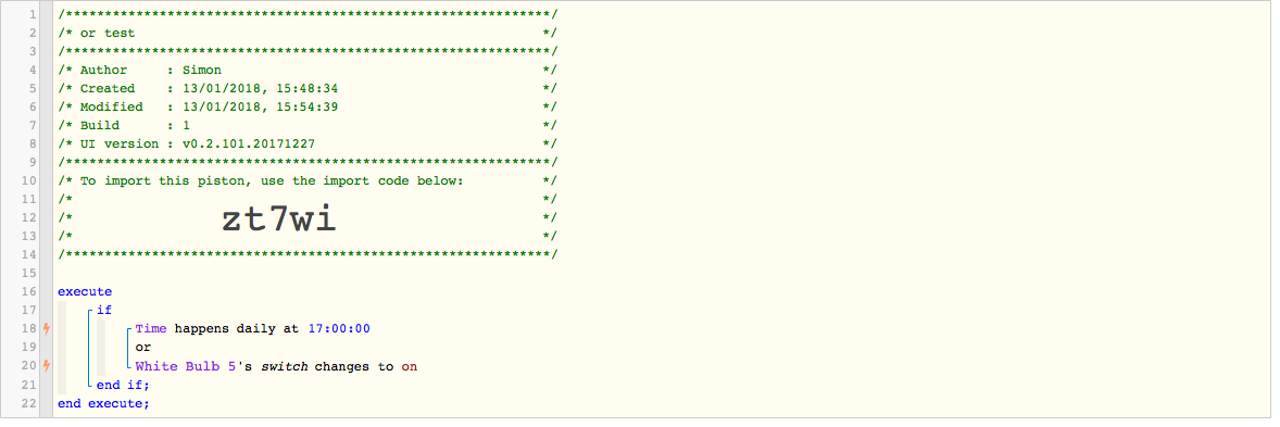

There’s no way that I’m aware of with WC to say something like:
Every day at 5PM OR if Switch 3 changes to ON.
But with my method you get the same effect (but w/o using the OR). They’re just two different triggers to the same called external piston.
