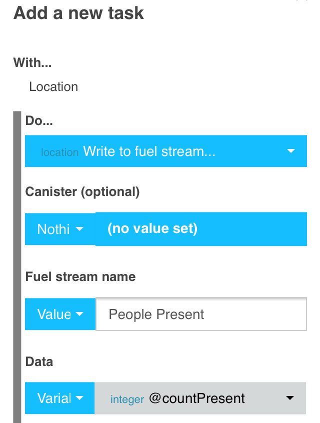

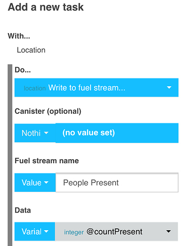

You need to choose the action ‘write to fuel stream’ and for the data section, select your variable (instead of the default value).
Place this action after the part of your piston that updates the variable, so it updates fuel steam at the same time.
Once the piston has run at least once, it will be appear in fuel streams.
