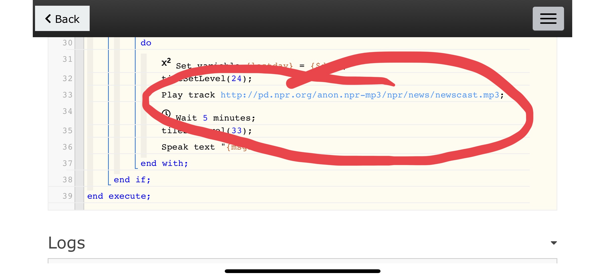

Can’t get this to run correctly
Still struggling folks. Is there a tutorial on what and how these functions are implemented. I could easily copy the pistons and adapt them but I’d rather know why and how they work. Like for example, I don’t even know how to and where to find the settings for they variables posted above. I’m particularly struggling on the ‘only run once per day’ settings.

I do not understand what you are asking specifically. (variables do not have settings)
Can you rephrase please?
yeah sorry, i didnt phrase that correctly.
What i mean is i not sure what to select from all the drop down boxes when im wanting to set up the piston to run only once daily. Ive looked at the options and i cant see the , integer lastrun option so i can make this piston only run once per day.
Thanks
For a variable to be visible from a drop down menu when coding, it must first be created up top in the define section. (as shown here) That is also the area where you specify if the data is going to be an integer/decimal/string etc. In your case, you want the {lastRanOn} variable to be an integer, since it is only counting whole numbers.
Normally, I define the initial value up top like this:
What this means is the variable will only change when the code below tells it to.
