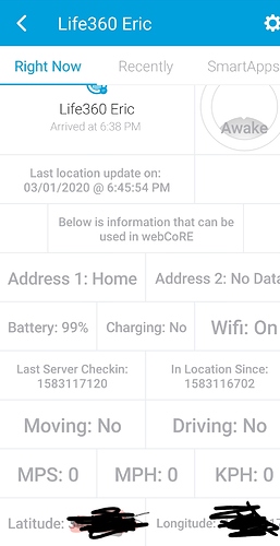

I have a “presence” piston with a bunch of different statements depending on whether I arrive at home, leave, arrive at a different location, etc.
One of the statements compares 2 variables, Distance1 and Distance 2 and performs actions based off the difference.
