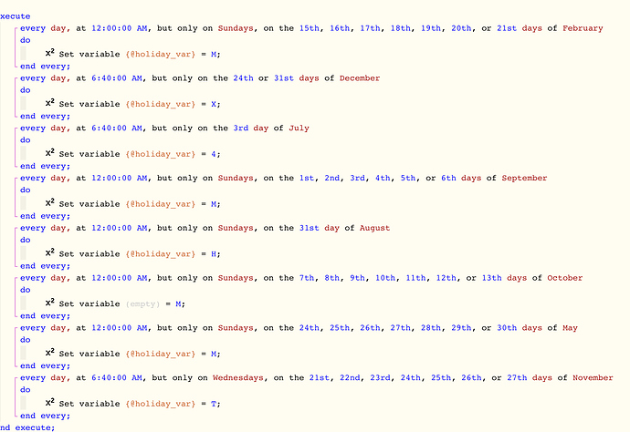

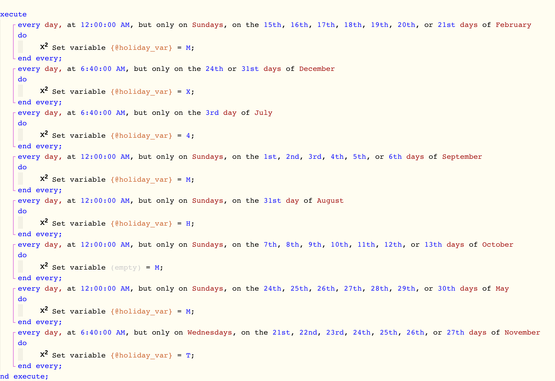

Some changes from the above. As I was building it I chose a string variable rather than Boolean. Perhaps I knew intrinsically that things would change… here’s the piston to set holiday variables. It now sets the following: X= Xmas and new years, 4= July4, M= the movable Monday holidays, T= thanksgiving. (edit: Aug31 should set M, not H)
And here’s the piston that makes the announcements on Echo at the desired times:
For the piston setting the variables, I might have it fire right after the old variable is set to H (essentially, clearing). That would allow me to ask “Alexa, what’s the next garbage day?” at any time, and it would respond accurately. That’s a more involved thing though. I did it with tasker, but it was not easy.
