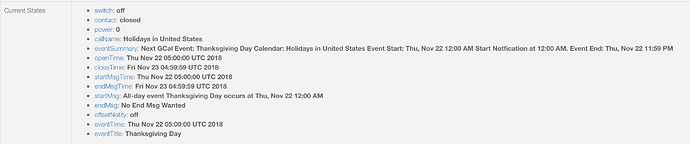

I’m with @Equis on this one using**GCal Search SmartApp by @infofiend *. Let the :man_student::woman_student: programming wizards at the ‘Google Calendar Division’ do the heavy lifting when it comes to the thousands of events surrounding special days. The possibilities are endless, for example, I also have separate monitored Google calendars for vacation, doctor appointments, family events, when I want a WebCore piston to be aware and take action.
In addition to US and Global Religious Holidays, the folks at Google have several other special date category calendars aside from Holidays, like Sports, Phases of the Moon, etc, each that GCal Search creates either a virtual presense or contact in the ST things.
I use those Gcals too.
Tell me how you would use it to give you a specific actionable variable the day before each major holiday.
@Glen_King: The GCal device for each Google calendar has the following robust set of device state attributes which are accessible from WebCore:

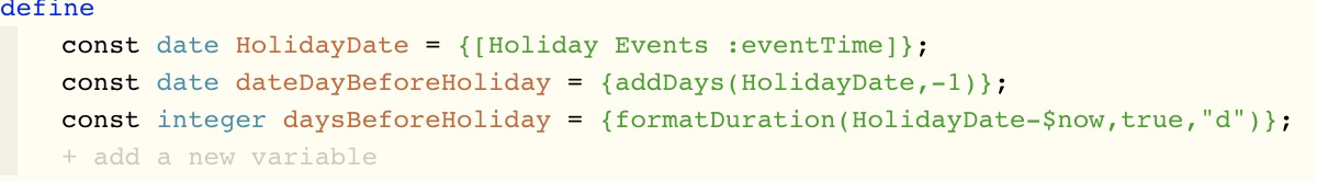

Here is an expression that generates the date before Thanksgiving.

Kurt, do you have to change that expression each year? I’m guessing that it would be easy enough to allow the year to be variable… it would be great to have a variety of pistons that can accomplish this task. Perhaps the one you are currently creating would work better - looking forward to seeing how it works for a slew of standard holidays…
#20
The one I posted above that creates dates for holidays could easily be modified to notify the day before, if you’re interested in it. Fixed ones could easily be added to repeat every year, too.
