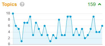

Ouch! Well, this is a forum designed to troubleshoot pistons…
We have over 6 thousand visitors a day, with only about 5 new topics a day.
pic
Personally, I think that is strong evidence that most of us have an awesome SmartHome.
Most of the topics here are when we are trying to do something fancy, and learning new tricks, LOL

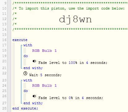

Here is a simple piston you can import, which should test fading both up and down.
(just import, point it to a single bulb, press Test, and sit back for 13 seconds)
pic
(I did not set the starting level, so the first time you press Test may react strangely)
You can play with the duration in this test piston, and once you find numbers that look good to you, then you can incorporate that logic into any piston.

I appreciate it. To be clear, my Sengled bulbs transition instantaneously. Possibly due to their firmware. I only want a small transition, and i want it to happen every time I switch them off/on or adjust the brightness. Is this piston likely to solve the problem?
The test piston is so your eyes can see how well Sengled handles the spam fade commands.
(I recommend setting logging level to FULL during your testing)
Once you find a delay that is acceptable to your eyes, then all your pistons that turn on or turn off that bulb can use the fade command you just learned. (instead of the normal turn on/off)
