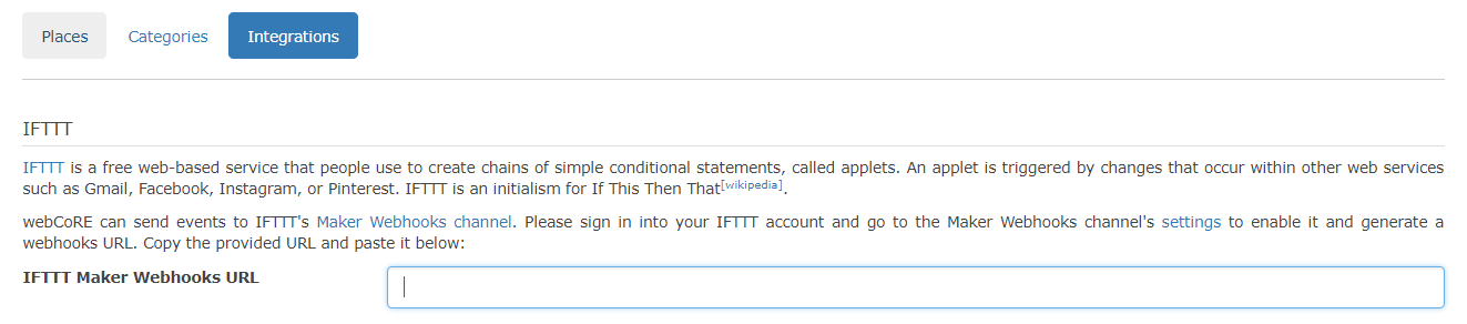

Yes… you need to setup the maker channel in IFTTT and copy the webhook URL.
Then go to the webcore dashboard, click options and then integrations:

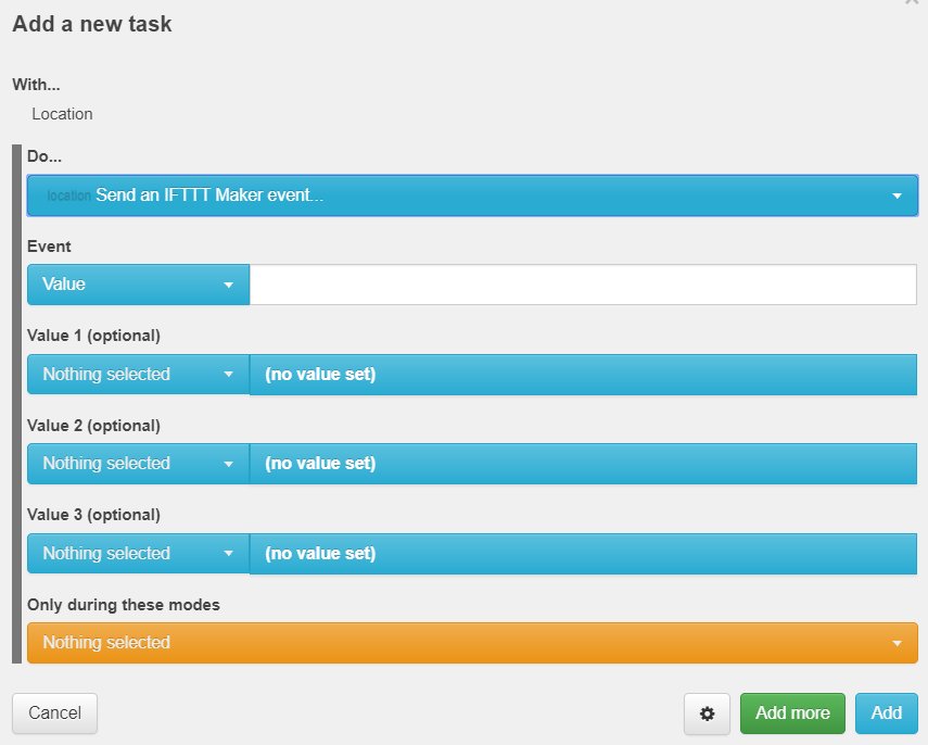

When building the piston itself, choose action > location > send an IFTTT Maker Event
