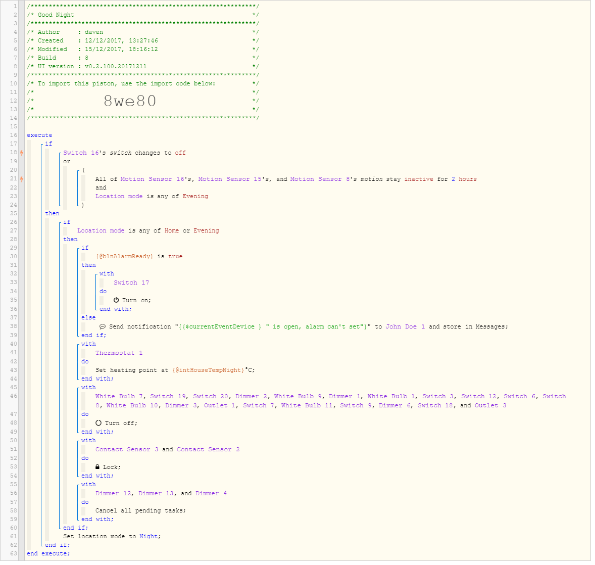

I thought Cancel All Pending Tasks scrubbed all the timers for the piston but I don’t seem to get that action. If I have the bedroom lights (Dimmer 4, 12 13) on when I put the house into night mode I don’t want the lights to go out 3 minutes later. Even with the Cancel the lights still go out via the timer set before the mode change. Does it not work because the timer was set by a separate piston? Can I cancel another pistons timers?
Cancel Tasks Query
daven
eibyer
I don’t believe you can cancel other pistons’ timers. You can however try to involve a switch or a global variable that the piston can subscribe to that if it changes to however you set it to will cancel piston tasks.
