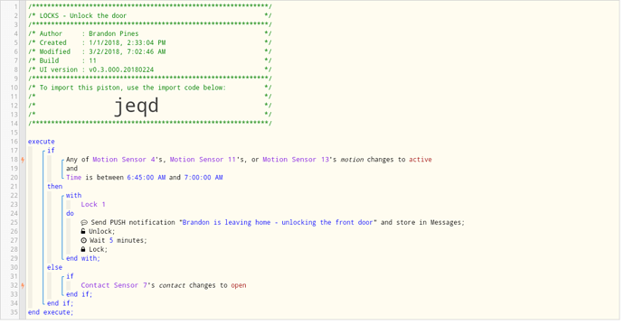

I would like to cancel the motion sense opening the door or unlocking the door once the door has been open for more than 2 minutes and not resume the motion sensor activity until the next day.
When the door has been open for X number of minutes cancel future motion sensor triggers until the next day,
I am not sure how to do the cancel part of the task

Add a variable?
If motion changes to active / Time is between / AND {Triggered} is false THEN
Actions
Set {Triggered} to true
Then, just set a timer to change the variable back to false at midnight or whatever time you choose. That would be the easiest way to me. Hope that helps!
