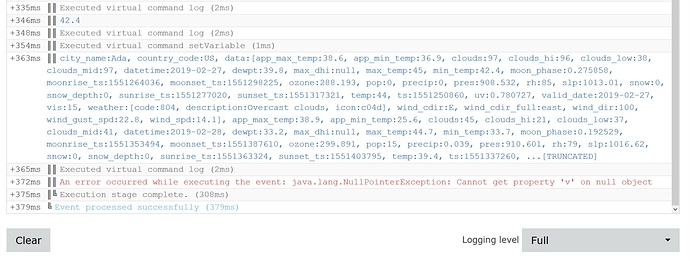

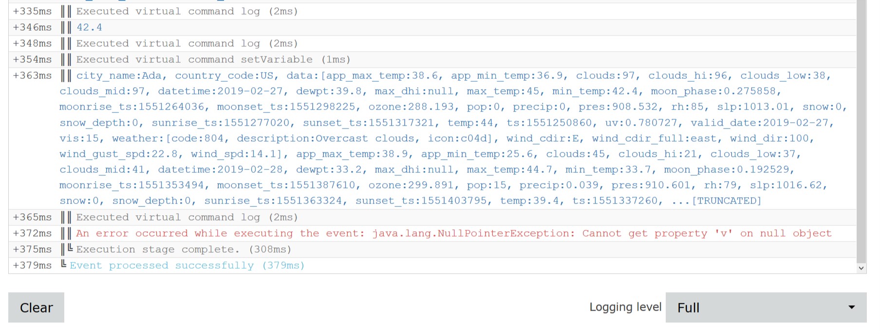

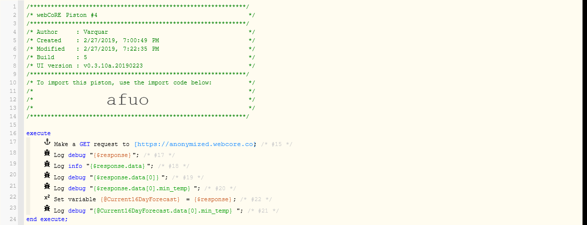

After setting a global variable using $response I can no longer access the child variables.
Continue to access the child variables in the collection as I did in the $response variable.
Cannot access the children in the collection.
