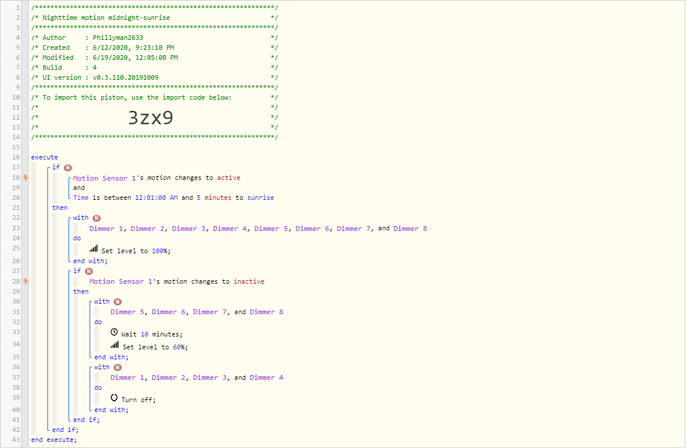

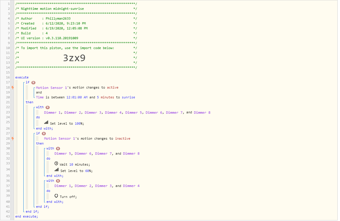

Hey guys, sorry for this because I’m sure it’s been answered 100 times but I have tried to apply other answers to other instances to my pistons and I just can’t get it to work right. I have a piston set where I have flood lights in front of my house that turn off at midnight. I have another piston where if the time is between midnight and sunrise and there is motion detected, the flood lights should come on, wait for 10 mins after the last “inactive” cue from the sensor, then turn back off.
Motion detected- flood lights come on, set to 100% brightness…Philips Hue candle bulbs in my door fixture go to 100%. After 10 minutes of no motion, floods turn back off, Hue candle bulbs set back to 60% brightness.
When motion is sensed, the “on” and “brightness 100%” instructions are executed, but the “inactive motion” for 10 minutes trigger does not activate the “floods off” and “candle bulbs to 60%” instruction. The lights just stay at 100% until my “sunrise off” piston.

I recommend two separate blocks for this. Something like:
IF Sensor 1's motion changes to active
   and
   Time is between X & Y
    Set level to 100%
END IF
IF Sensor 1's motion STAYS inactive for 10 min
    Set level to 60%
    Turn off
END IF
Notice the second block uses a slightly different trigger, so there’s no need for the WAIT.
(this also means that all TCP should go back to Default)
Pro Tip:
You can drag & drop that 2nd IF block down below, to save you a bit of time editing.
Sorry for the delayed response, was out of town for a couple of days. I just changed this, will give it a shot tonight in real time and report back tomorrow. Thanks for the advice!!
