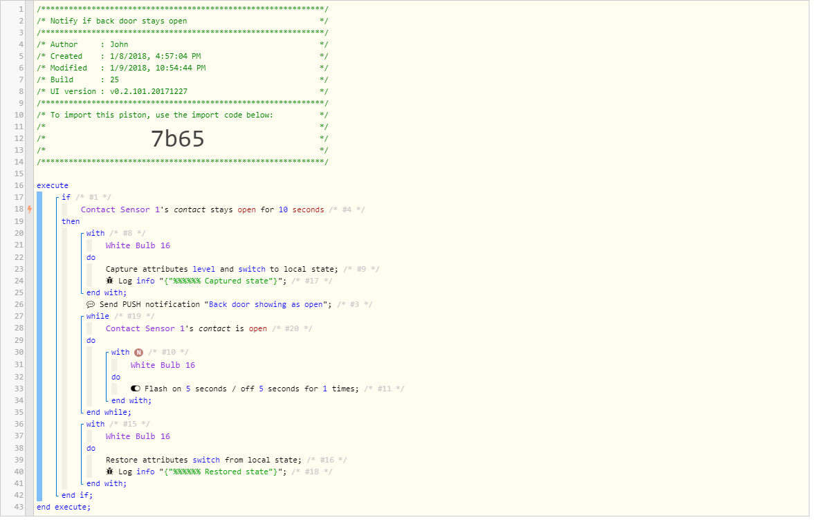

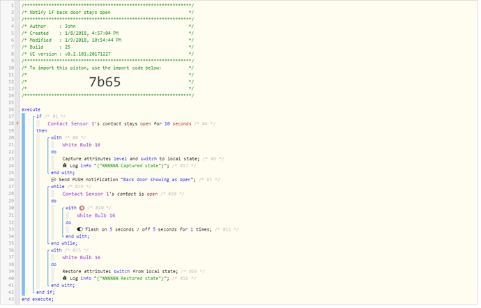

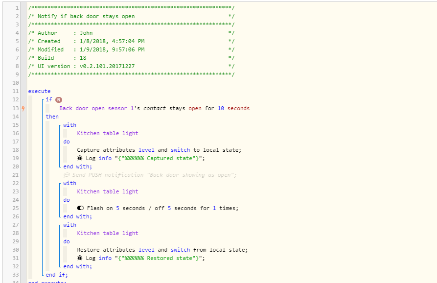

The statements in the then block should run to completion, but don’t
See above - I set the if block to “Never Cancel” but that doesn’t keep the tasks from canceling
The light should be restored, but the then block is canceled when the condition changes
