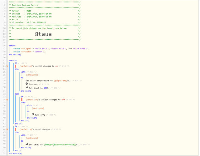

I am trying to control 3 dimmable, tunable white lights with 1 virtual switch. Things I’m trying to do with these lights:
- When the virtual switch turns on, do the following with all 3 lights:
a) Set light temp according to a global variable
b) Turn on
c) Set brightness level to 100% - If the virtual switch level changes, change the brightness level of all 3 lights.
This all generally works. However, when I try to issue an ‘on’ command immediately followed by a set level command, it only turns on the lights to 100% (the set level command doesn’t work). The set-level command 'waits at a semaphore for 10s, and doesn’t seem to be issued. If I issue a wait for 2s between the on and the set level commands, it works.
Expected behavior is I can issue an on immediately followed by a set level command.
Issuing an on followed by a set level command only turns on the lights at 100% brightness. The set level command doesn’t succeed - it says waiting at a semaphore for 10s. I’m guessing this has to do with the fact that the trigger for switch on and level changed is in the same piston?
6/16/2019, 1:04:16 PM +984ms
+2ms +Received event [Switch (Virtual): Bedroom].level = 25 with a delay of 71ms
+10137ms ¦RunTime Analysis CS > 22ms > PS > 10065ms > PE > 50ms > CE
+10138ms ¦Piston waited at a semaphore for 10020ms
+10141ms ¦Runtime (39145 bytes) successfully initialized in 10065ms (v0.3.10c.20190522) (10138ms)
+10142ms ¦+Execution stage started
+10159ms ¦¦Cancelling condition #10's schedules...
+10160ms ¦¦Condition #10 evaluated false (12ms)
+10161ms ¦¦Cancelling condition #1's schedules...
+10163ms ¦¦Condition group #1 evaluated false (state changed) (14ms)
+10175ms ¦¦Cancelling condition #6's schedules...
+10176ms ¦¦Condition #6 evaluated false (10ms)
+10178ms ¦¦Cancelling condition #2's schedules...
+10179ms ¦¦Condition group #2 evaluated false (state changed) (14ms)
+10189ms ¦¦Comparison (integer) 25 changes = false (0ms)
+10190ms ¦¦Condition #38 evaluated false (7ms)
+10192ms ¦¦Condition group #37 evaluated false (state did not change) (8ms)
+10194ms ¦+Execution stage complete. (53ms)
+10196ms +Event processed successfully (10196ms)
