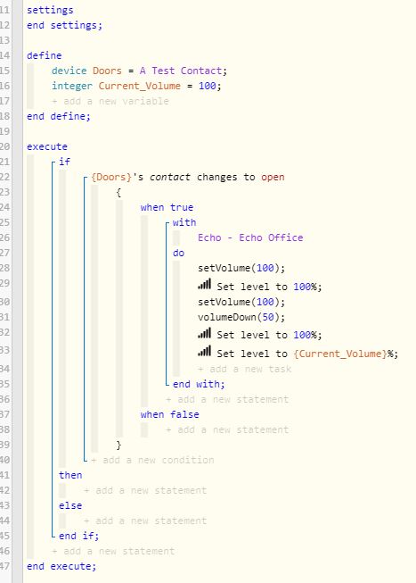

New to webCore and trying to get familiar with everything. Right now I am just testing different things.
Right now I am trying to just set the volume of my Echo Spot.
I am using the SmartApp “Echo Speaks” (Or is there a better option)
I have tried several different things to change the volume with no luck.
My goal is to eventual get the current volume, store that, set volume to max, speak something and then return volume back to stored volume.
And play on all selected Echo devices (In Parallel)
here is my code for testing noting chnages the volume
