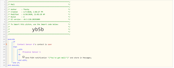

Designing a piston to notify me if the mailbox is opened, using a door contact.
I should be notified when the mailbox is opened.
In the piston I used “is” but is that the best idea for what I want? Changed? Changes to? Changes from? Changes away from? Is? Ugh!

Oh I only threw the “is” in there so I’d have a complete piston to put here in the thread!

As a side note, in this situation since you only have one condition, webCore will treat it as a trigger so you should get the same end result. Notice the lightening bolt beside the ‘is’ statement. Just be aware that adding more triggers/conditions will affect the logic.
